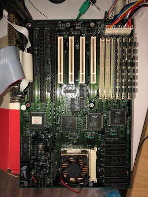

Reply 21 of 36, by s.mouse
I have a new socket 4 puppy. PS/2 mouse, No Ide/ serial on board and removable cache chips.
With 512Kb cache it scores marginally higher that the DFI around 10 realtiks

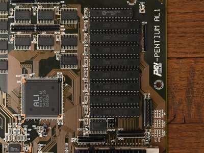

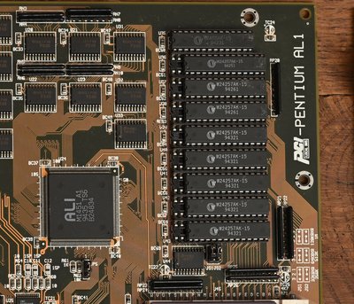

Talking about removable cache chips and extra cache. I upgraded L2 cache on my Socket 4 board listed earlier on this page from 256kB to 1024kB.

I believe the new ISST branded chips from eBay (marked -10ns) are fake. However, at least they do have advertised capacity. I reused one of the original 32k Winbond chips as a tag SRAM as I needed to go from 8kx8 to 32kx8 to support 1M cache and there is only a short DIP socket.
It gives the motherboard a heathy boost in some benchmarks (Doom, PC Player). About 16%. It is enough for a P66 to go over my P75 in some tests...
I wonder if I can get even better performance by using faster tag cache chip...

Reply 25 of 36, by mpe
feipoa wrote:
I thought direct-mapped cached needed a 64kx8 TAG to use 1024K cache?
Isn't this for a 486? Pentium's cache lines are 32B instead of 16B and thus less tag RAM space is needed...
Anyway, this system only has DIP28 socket for tag ram and yet supports 1024k of cache.
Blog|NexGen 586|S4
Reply 26 of 36, by feipoa
You might be right. I checked some of my socket 5 board manuals and with 1024K and they call for one or two 32kx8 TAGs. The second TAG for dirty.

Reply 30 of 36, by mpe
Yes. L2 cache coherency is quite a bit different between 486 and Pentium (MESI instead of as simple dirty bit, line size, etc.)
Not sure I've seen a dedicated dirty tag SRAM in a Pentium system, but there could be. But if I am correct some chipsets from this era used internal 32Kx1 MESI for dirty bit and combined internal/external SRAM to get required cacheable RAM limit. But I can't find any information about this particular ALi chipset.

I finally got the Batman's Revenge board which is a kind of reference board for Socket 4. So I was able to calibrate my results against s.mouse's results (despite a slightly different VGA which is S3 868 in my case.
It looks like the MSI/ALi board at default settings is slower than 430LX, but given its expandable L2 and a plenty of tweaking options can be tuned to surpass the Batman board (and I still haven't exceeded potential as I can't run it stable without L2 wait states).
Being made by Intel, the Batman's Revenge has no tunable options. So its defaults is the best it can do.
