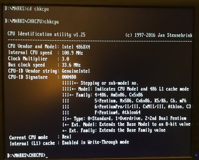

Vegge wrote:
Did some more research based on my guess of J35, J36 and J37 that are close to the frequencygenerator. Came up with this.
So it seems that J37 switches between 25 and 33MHz bus.
Yes ! Now it’s working at 100mhz.
I removed jumper 37 and set the other CPU jumpers to work with Overdive CPU.
Thanks peoples.
