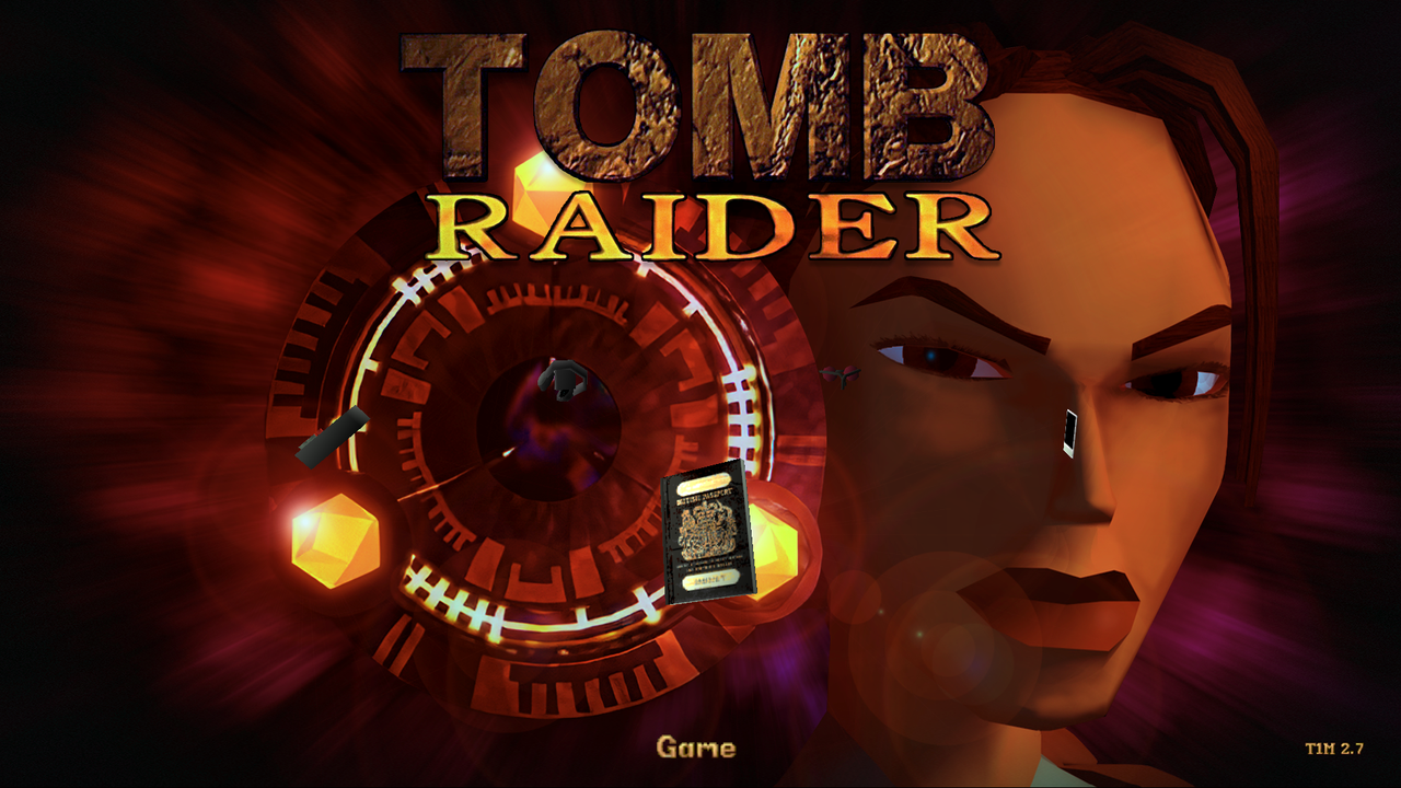

About WarGus above. The Stratagus executable can still be run with a particular Kernel32 wrapper dll. It was supplied by KawaiiSaras, and hosted here at Xin.at. I tested it with War1Gus, the one for Warcraft 1.
But the main thing I want to add is this unofficial build for Tomb Raider 1, being a build of Tomb1Main v2.7 for Windows XP. This should end any annoyance with the original ATI version of the game and the Windows XP incompatible GLRage wrapper.
You can find it at the downloads section here: http://www.gb-homepage.nl/index.htm
The package comes with required FFMpeg dll's, and those are 30MB unfortunately. But I don't feel like building them myself just to shave off the unused video codecs.
Also: The similar OpenLara project runs on XP with a small NT version hexedit. With the current Win32 executable dated 24-03-2021 that is. Note that on my system I have to delete the generated xsh shader files before the next start of the game, otherwise it crashes.
My take is that OpenLara looks nicer in general, but has some small gameplay issues compared to Tomb1Main and the original Game.

Reply 33 of 238, by gerwin
Tom.. wrote on 2022-04-25, 06:12:
I will answer here. I cannot send private replies yet.. AMD Duron 750 MHz - GF2 MX 200 - 768 MB Ram WinXp SP3 . I am getting su […]
AMD Duron 750 MHz - GF2 MX 200 - 768 MB Ram WinXp SP3 . I am getting such an error..
AMD Athlon 64 3000+ - Radeon 9800 Pro -2GB Ram WinXP SP3.
On an older version vc_redist.x86.exe (2015) I have this error
Maybe it works on newer computers? Core 2 duo ?
Unmodified version "Tomb1Main-2.7" works fine i7 4790k - GTX 970 - WIN10 PRO..
Thanks for the feedback.
I just uploaded a new version of Tomb1Main-27-XPmod.zip with a single change: SDL2.dll is now the official v2.0.14.0 distribution. Any older version like v2.0.12.0 does not work. The previously included SDL2.dll had undesirable MSVC dependencies.
About compatibility: I ran a few tests:
Windows XP x86, Core i5-3550, Radeon HD6570 -> Only XPmod one works
Windows XP x86, Core 2 Duo P9600, Geforce GT710 -> Only XPmod one works
Windows XP x86, AMD E-350 APU, Radeon HD6310 integrated -> Only XPmod one works, Cannot maintain 30 FPS.
Windows 7 x64, Core i5-3550, Geforce GT710 -> Works, both XPmod and Official
Windows 7 x64, Core i5-3550, Intel Graphics -> Official/XPmod both do not work, GL_EXT_gpu_shader4' is not supported / 'textureSize2D' : no matching overloaded function
Windows 10 x64, Core i5-8250U, Intel Graphics -> Works, both XPmod and Official
Windows 7 x64, Core i7-930, Geforce 210 -> Official/XPmod both do not work, S_Shell_ShowFatalError Shader compilation failed
Windows 7 x64, Core i3-2310M, Intel Graphics -> Official/XPmod both do not work "Shader compilation failed"
Windows XP x86, Core i3-2310M, Intel Graphics -> Official/XPmod both do not work
It seems it is about Graphics here, not about CPU extensions...

gerwin wrote on 2022-04-25, 13:58:
This result seemed like an anomaly to me. How 2016 NVidia drivers can trip over a bit of shader syntax?
I found Tomb1Main can run properly on this system with a simple edit of the four shader files in the shaders folder. 2d.fsh 2d.vsh 3d.fsh 3d.vsh
First line:
#version 130
change to
#version 330
Works now too. You can assume it also goes for the other Windows 7 Intel Graphics system that I listed earlier. Though because of the framerate this is not a playable combination. At minimal settings it still drops below 30 FPS in many areas. Same type of laptop but with Windows XP won't start the game.
See this issue at github where they labeled their v330 shader files to v130 in order to improve compatibility: Without any adjustments to the shader code itself.
https://github.com/rr-/Tomb1Main/issues/327
That was not a good idea in theory and practice.

Reply 38 of 238, by Tom..
Thank you
I did as you wrote, the game works 😀
