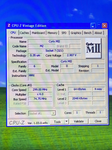

Nemo1985 wrote on 2022-03-12, 02:25:
Probably, still the higher v2.9 frequency is 250 mhz (little to none overclocking chance), while the v2.2 is 285 (or 300 for the […]
Probably, still the higher v2.9 frequency is 250 mhz (little to none overclocking chance), while the v2.2 is 285 (or 300 for the almost impossible to find 433gp).
That's the performance difference at 250mhz clock:
The configuration was slightly different compared to the 200 mhz, but somewhat comparable.
At 200 mhz the difference (quake 320 resolution) was 1,7 fps, while at 250 mhz it was 2,2!
So apparently going up with clock increase the performance gap.
Yeah, we’re overclockers here. We care about max stable frequency! :p

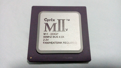

Reply 21 of 98, by Nemo1985
Sphere478 wrote on 2022-03-12, 02:53:
Yeah, I’m still looking for a 433gp. There are two models. I may have mentioned. a MII and a MIIv which as far as I can tell are actually exactly the same thing 🤣 aside from the extra letter on the label. But I suppose it could be said that the 400gp is also basically the same thing 🤣
I read around that the v was used to mark the models for laptops (this time I have the source: https://www.cpu-world.com/forum/viewtopic.php … er=asc&start=15)
It would be interesting to check if there is, as always with cyrix, any subtle difference between the 2 versions.

Reply 22 of 98, by Tetrium
Nemo1985 wrote on 2022-03-12, 03:00:
I read around that the v was used to mark the models for laptops (this time I have the source: https://www.cpu-world.com/forum/v […]
Another interesting link: https://www.cpushack.com/CyrixID.html
Perhaps the laptop versions are rated at higher maximum temps?

Reply 23 of 98, by BitWrangler
According to the IBM thermal design doc (pulled mine from the CPU docs at Ardent Tool) the F stepping runs a few watts cooler than previous steppings. IBM weren't still "in" by the time they went to 0.25 micron were they? I'm wondering if that's where the assumption or confirmation of a 0.30 micron shrink came from.
Anyhoo, if you wanna pre-sort your silicon lottery tickets, the F stepping is the one to look for. My IBM PR266 is an F, w00t I guess.
edit: Found a pic of the 366.. v7sp8910bd ... that seems to be National Semi, Made in South Portland Maine, 0.25 micron, 1999, week 10, (Hey, Happy Birthday 366GP) that one is a 2.9V 2.5x100 marked CPU and did ~290Mhz and that's as much as the board let it I think.

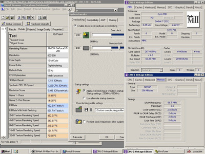

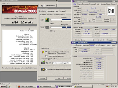

Reply 28 of 98, by Sphere478
BitWrangler wrote on 2022-03-12, 05:53:
They really like overkill cooling, don't stick a P54 sized heatsink on it, stick a Duron sized heatsink on it.
got a big ole 370 copper on it.
Necrodude wrote on 2022-03-12, 07:19:
Sphere478 wrote on 2022-03-10, 06:42:
It’s about time Cyrix/ST/IBM got some benchmark competition love, […]
Let’s see those 3dmark 2000 and 99 scores!
Feel free to drop any other benchmarks you feel are appropriate also.
I’ll be using a 400gp for my entries.
Only rules are, default benchmark settings, driver tweaks are allowed, so long as you tell us about them so we can use them :p! Overclocking is allowed, any gpu, any mobo, must have a sound card, must be a cyrix mII 433 or prior (none of that via stuff) ST and IBM also count as okay. (Same chip)
Awesome initiative! Love it!
Thx 😀
Update: 366gp at 100x2.5
Only got 1200-1300 in 3dmark 2000

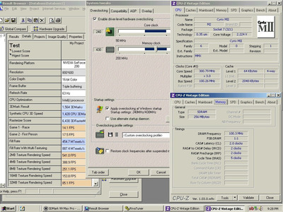

Reply 32 of 98, by Imperious
I did some tests with my 333gp (2.2v) and the same rig I've used for the P233mmx stars and K6-2/K6-3 Stars threads.
Reply 33 of 98, by Sphere478

Reply 34 of 98, by Imperious
I did those tests a while back, May last year. I seem to remember trying higher speeds but can't remember whether I tried over 2.3v or not. You are correct about the heatsink, no corner support. This chip was brand new from that China Zoe Ebay seller. I also got a Rise iDragon cpu of them, must give that a try sometime.
This is Epox MVP3G5 with Gf3 ti200.
The best overclocker as far as IBM/Cyrix chips I have tried is the 6x86mx pr166, it did 200mhz no problems. For some reason though all these chips give random lockups on this board, it's a lot more stable with Pentium mmx and AMD K6 series.

Those silver top Cyrix MIIs were all manufactured by IBM. They're 2.2V and .18 micron. Officially they shouldn't exist, but for some reason they do.
I had never really noticed them in the past, but recently a whole bunch started showing up online.
