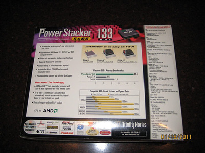

Had any luck? I got my hands on a PNY Powerstacker (an interposed AM5x86-P75) and I'm trying to get it to work with a PS/1 2133-F43 (originally with a 20Mhz CPU) but I can't get it to POST 🙁

Actually my board doesn't have a soldered CPU, it has a socket for both CPU and a 487. I tried both way, with the Powerstacker into the main CPU socket, and in the 487 socket, neither works. The PNY Powerstacker does have the extra pin for being fitted into 487 socket. I'm leaning toward BIOS incompatibility, although I have no real way to know if the Powerstacker itself isn't broken. I don't have another 486 handy to test it out sadly. I'll try to find an ebay listing for 486 DX2/66 5V cpu not too costy and see if works. That at least would be a nice upgrade from the SX25, although I'm not sure the board support 33Mhz FSB.

Just found a picture of a Powerstacker 133 box with a list of non-compatible system. Sadly my IBM PS/1 2133 is part of these.
Looks like I now have a costy paper weight. I might try to find a clone 486 on eBay that won't cost me an arm and leg.
