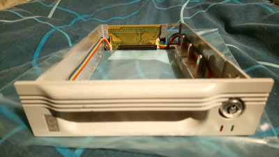

Ok, I have 2 of same docks you have but 2 different caddies - one has wide cable, one .
May I you post a picture of the caddy (without hard disk) please?
My docks seem to be the same, but their behaviour is different on my 2 caddies - as far as differential is concerned.

Reply 27 of 81, by teh_Foxx0rz
Disruptor wrote on 2023-11-06, 20:05:
I actually have two kinds of SCSI bays; the other kind has no back on the caddy, and just slots the SCA connector of the hard drive directly into a connector on the dock.
But here's a photo of the kind I'm using here, with no hard drive.
They all have this SCA connector for the hard drive and the 68-pin "wide" connector on the rear, however.

Reply 28 of 81, by ElectroSoldier
Yeah the Adaptec 2940U2W and other 2940 cards have strayed or are starting the stray into the retro catagory and so carry a "retro tech" price tag.
Take a look for an Adaptec 29160 or 39160 ... Anything SCSI 160 infact as thats not cool enough to be retro yet.
https://www.youtube.com/shorts/zRFF4X1IxdQ?feature=share Adaptec ASC-29160
Thats a controller you need for £11.99
The ASC-39160 just adds another controller and put the 50 pin connector in a better place for actual use inside the PC case.
And yes I know it will work because I run a SCSI-2 Pioneer 6 disc CD changer off of a ASC-29160LP
On the controller card you have, it the option to Send START UNIT command option set to ON?
