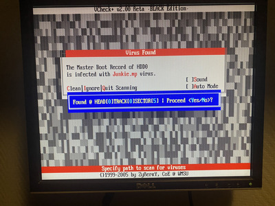

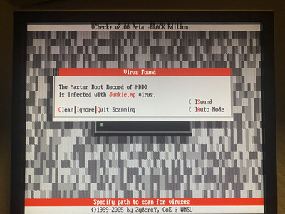

Reply 32 of 37, by cross
So everyone, if you are still following! 😁
After dealing with one very unreliable ebay seller, I was able to find another seller with a V30 that arrived yesterday.
I plugged that one in, booted up from clean floppy and was able to run Masaw´s amazing program without any issues!
And yes, my memory was correct. The machine had a virus on it. Called "Junkie". (Not sure where i got "Banana" from though 😁
Reading up on it, it looks to be highly contagious, however pretty "Harmless". Most likely why nothing was ever seen on the machine while using it

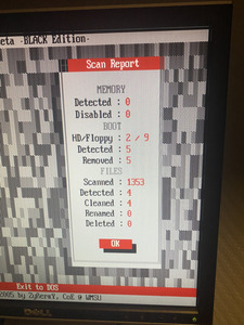

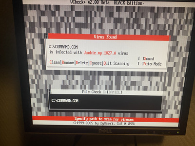

VCHECK correctly identified it on the MBR and even some of the COM files and successfully removing it. Can also confirm that the virus was still active before this, as all the floppy that touched the machine was infected. VCHECK was able to clean this also.
Initially I was thinking of filming it just to show VCHECK work and how it looks when/if it found anything. However, process took a while. What I did instead though, was taking screenshots of the prompts when it found the virus on file.
So all good now, with this new CPU, I was also able to make one of my ZIP drives to work with it. Pretty amazing that the ZIP works on this machine!
It is currently copying all the files over to a ZIP-disk for preservation. Found alot of fun memories on the drive that I want to keep around. I guess these HDDs are not super reliable after all these years.
