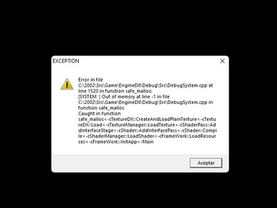

EDIT #2: Cabela's 4x4 Off Road Adventure 3 crashes back to the desktop on modern versions of Windows to a rather stupid memory limitation imposed by the developers. Quite annoying.

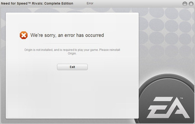

EDIT #4: Then again....another recent game. Need For Speed: Rivals (PC, Ghost Games/EA, 2013) won't run on 64-bit versions of Windows as its corresponding binaries suffer from bad DRM implementation. #StillUnfixed

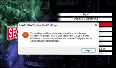

UPDATE: SEGA Rally 2 (SEGA, 1999) won't show its Device Settings prompt thorough the game's launcher as the required file -SR2_CPL.cpl- appears to be missing, thus making impossible to rebind them driving commands to either any joystick, gamepad or steering controller for that matter. #PleaseHelp
Speedwarrior956 wrote on 2023-04-14, 15:48:UPDATE: SEGA Rally 2 (SEGA, 1999) won't show its Device Settings prompt thorough the game's launcher as the required file -SR2_C […]
Most games of that era run the "Set up USB Game controllers" now. Maybe opening that is what you need.
No, SEGA Rally 2 has its very own control panel applet and can't install it.
