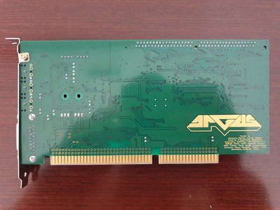

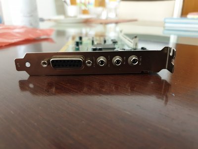

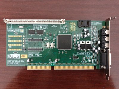

Just a small FYI, I've finally put my hands on my assembled ARGUS prototype #7 (thanks, keropi!) and tried a CT4170 bracket - it fits almost perfectly (taking into account the already known "bug" of the spacing between the jacks that is slighly bigger than needed; but the jacks holes on the bracket fit even without any further drilling), all jacks markings are correct, looks great. I said almost - as there was no hole on the ARGUS PCB for the metal support screw. So, I've drilled it, and here we go:
265.67 KiB
2770 views
406.5 KiB
2770 views
564.79 KiB
2770 views
In my book it's a perfect bracket for the ARGUS, and there are plenty of those CT4170/CT4180 available for cheap.
I know that we've already discussed this, but... maybe... it would be still possible to add this mounting hole to the final production design? It would make the life a lot easier for one who decided to go with the Creative Vibra bracket!
P.S. I haven't tested it yet, and have a slight concern - could I have shortened anything while drilling that should not be shortened? Any inner layers, etc.? Please tell me before I plug it in and get some magic smoke 😁

ARGUS is a two-layer board; there are no inner layers to damage. If the bit didn't "skip" around too much and you made a clean hole, I would expect that it's reasonably unlikely that you caused catastrophic damage, as long as you didn't compromise the bond between the copper and substrate or crack the vias. If I'm not mistaken, that area is a ground fill on both sides, so you're probably safe to test. Still, drilling through an assembled board isn't something that I would generally recommend.
