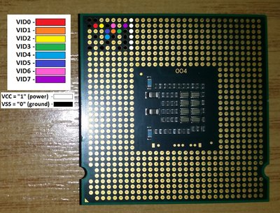

@agent_x007 I finsh, i activate flexibility option and fixed 533 speed of ram, my multiplicer is disabled and fixed in 14, now its posible 225 mhz but in 230 the benchmarks or any games not execute correctly, is posible make in "paint" a schema for force vcore vid mod please?.

x14 is too much without Vcore VID mod. Try x10 first and increase it from there.
Flexibility option decreases RAM speed to 400MHz, so don't use it if you don't have to.
Vcore VID values vs. VID pin values, are available in table here (page 17) : LINK
While VID pins are in the same place as in PDC from page before (you can check with page 45, just to be sure)

Regardless of whether this is 10 or 15 there is no difference, the benchmarks and games fail the same.
what mod vcore is something that I do not finish to understand, I assume that to make that mod aique join the vid0 to a ground truth?

Reply 223 of 892, by agent_x007
It's a bit more complicated than that.
First you need to know you base VID (stock Vcore voltage value, set by Intel in factory).
With it, you check how it looks as High/Low signal on VID pins in VID table (my previous link).
After that step, you must think of what pin you can easily connect to ground (Vss), or VCC to get on it High ("1") or Low ("0") value (coresponding to VID table value it represents).
Then you connect pins with tin foil or silver pencil.
Example :
Let's assume my stock VID (Intel's Vcore) = 1,25V.
Vcore at 1,25V requires pin values :
VID0 = "0", VID1 = "1", VID2 = "0", VID3 = "1", VID4 = "1", VID5 = "1", VID6 = "0".
"1" = VCC
"0" = VSS
In this case, I would recommend setting up VID mod to Vcore = 1,45V, which looks like this :
VID0 = "0", VID1 = "1", VID2 = "0", VID3 = "1", VID4 = "1", VID5 = "0", VID6 = "0".
It only requires connecting VID5 pad/pin to Vss that is above/below it depending how you position CPU (you can check where Vss pins are on Socket relative to VID5 pin on page 45).
Pin VID0 does nothing for QX9770 (it's always at "0", and there are no values in VID table for it at "1").
