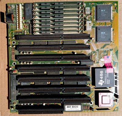

Reply 236 of 553, by Eep386
Just a quick report - the MR BIOS image for the Octek Jaguar V seems to work on my C386MX board with an MX305/306 chipset. And it works vastly better than the AMI BIOS it replaced.
Using the stock 386DX-40 CPU, no FPU. Don't have a 486DLC to test.
Life isn't long enough to re-enable every hidden option in every BIOS on every board... 🙁
