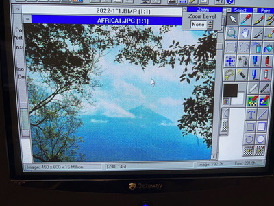

Reply 222 of 661, by tabm0de
I know this is to much to ask, but has any one tried windows 3.1? 😉 it just jumps back to prompt when trying to run it. installation works fine.
*edit, strange does start if i typ "win /s" ( Start windows in standard mode) no ide what mode it tries otherwise haha

Reply 223 of 661, by rasteri
tabm0de wrote on 2022-11-27, 19:18:
Windows usually starts in 386 enhanced mode, standard mode is for 286s. Check your DOS memory setup maybe?
Reply 224 of 661, by tabm0de
rasteri wrote on 2022-11-27, 19:40:
I just tried everything out of the box, haven’t check anything els to be honest except a svga driver with 256 colors.
*edit did a reinstall again on top the existing and it just started to work, no ide what happened first time.
Things are looking good 😁

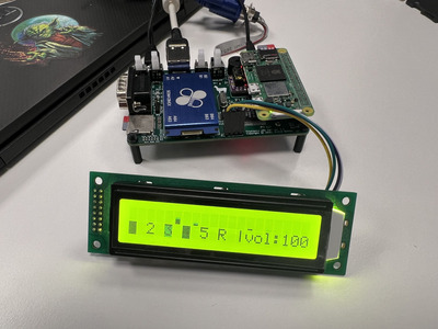

Finally my first one is 100% done.
I just wanted to post all thing around the soldering that i have hade problems with if it could help any one in the future 😀
My plan was use pcb stencil with hotplate for all the small components, which in my world was suppose to be easier.
First board i did have problem that the bord was just keep restarting and did not find a real issue, so resoldered all the components again by hand instead and booted fine 😉
Second board was done by hand instead of hot plate, which i most say was way easier then expected.
Stupid problem i had with this one was that the board just hang on bios when sd card was inserted, that was due to a pin for the sbc wasn't soldered 100%
I also hade one problem where i did not get any mt32-pi sound, my first step was to remove the pc speaker and then try the output on the GY-PCM5102 which also didnt output anything, as always at least for me i seem to get a non working PCM5102, doent matter if i buy the cheaper version also, so i would recommend put in the pc speaker after testing mt32-pi.
When having problems with usb mouse, i just gab a cheap non power usb hub that i had and connected the mouse to it, then the mouse worked without problems 😀
Otherwise the project is fun as hell, but i do get it takes time to put one together 😀 my plan is to make 5 and probably sell 2 of them to cover my expense 😀
I will also make few clean sd images, dos 6.22/win3.1 , windows 95 and windows 98 just to be able to simple switch between OS.
* YES i do know the bigger screen looks silly, but i rather have a bigger one 😀

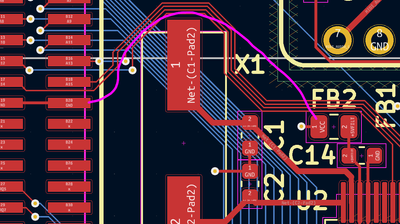

Reply 226 of 661, by tabm0de
Question regarding "Pin 23 (FORCEON) should not be tied to GND, because this enables auto-powerdown which doesn't play well with serial mice. Instead, it should be tied to VCC to disable the feature."
The only "Pin 23" i can think of, and easiest fix for that would be something like the picture if im not wrong ( of course cut it away from GND first )? or är jag ute och cycklar ?

Reply 227 of 661, by Eivind
tabm0de wrote on 2022-11-29, 09:19:
I see I forgot to mention which IC I was talking about in the errata document (I've rectified that now). It's the MAX3243 chip, and has nothing to do with whatever you're showing in that screenshot you just posted! 😀
For more info, take a look here.
