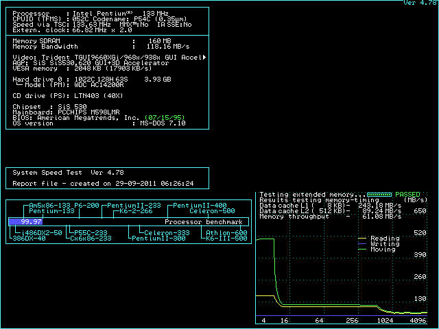

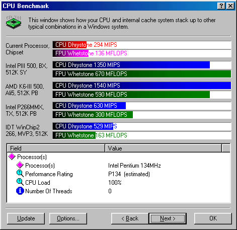

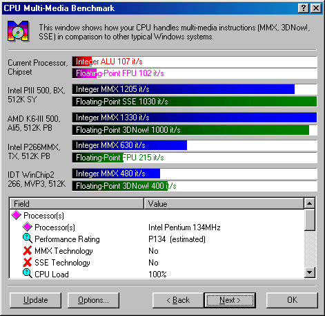

Reply 36 of 62, by sebaz_ri
Pentium Classic (P54C) 133
3Dbench 1.0=90.9
MDKbench=59
PCPbench=14.6
Quake - timedemo demo1=28.1
timedemo demo2=29.1
timedemo demo3=26.7
Speedsys
Sandra 99
