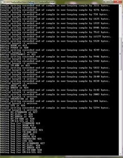

@kitrinx, @newrisingSun and all others 😀 crazy guys are here:-) sf2 works 😀 sometimes i think, your former employee was Roland 😀 Thank you so much for all the work.
Compiler under windows compiles even with noted compiler options with a lot of warnings, but at the end, sf2 is created.
Attachment shows errors during creation under gcc windows. Never than less, very very exiting work.

Yes, lots of printf's. Not all of those warnings are significant, but it's good to be aware of them. If all went well, the SF2 should sound pretty good in fluidsynth or another full features soundfont synth. Instruments that rely heavily on the other two envelopes will understandably not sound correct.
