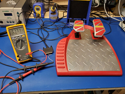

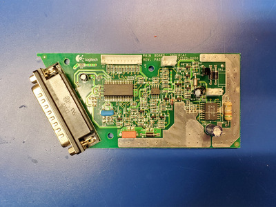

Reply 24102 of 27685, by Shponglefan
BitWrangler wrote on 2023-03-30, 15:53:
Shponglefan wrote on 2023-03-30, 15:40:
Testing out a Logitech Momo driving wheel I picked up recently. […]
Everything works except for the brake pedal. For whatever reason, it shows as fully depressed (100%) in the Logitech software. Pressing the brake pedal doesn't change anything. Meanwhile, pressing the accelerator causes both the accelerator to move to 100% and the brake to reduce to ~5%.
Tested this on two different computers with two different operating systems (Windows 98SE and Windows XP) to rule out any system shenanigans.
I popped open the pedals themselves to test some things. Continuity seems to be fine through the attached cable. And the pot itself seems functional, although I don't know at this stage how it is calibrated and what the expected values are.
I'll need to do some more testing with the unit plugged in to see if I can get any response from the brake pedal's pot. Then maybe need to pop open the wheel itself, since everything runs through that.
Are they not wired as top and bottom of same axis? If you were using a joystick, you'd be pushing forward or pulling back on the Y. ... though true simulation you should be able to do both at once, to destabilise vehicle on accel and brakes for throwing it sideways in turns.
They appear to be, although the drivers do allow for recognizing the pedals as independent axes.
But having tried it both ways on two different systems, I still can't get any recognition from the brake pedal.

Reply 24103 of 27685, by rasz_pl
sure sounds like some backward compatibility mode, you might have more luck asking on racing forums with people knowing those wheels intimately

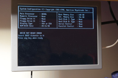

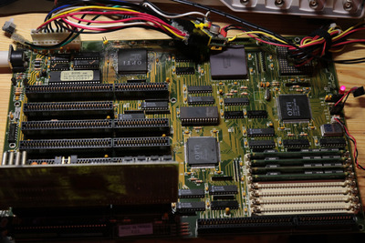

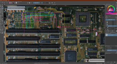

At last I've sort-of managed to troubleshoot something using my oscilloscope. I posted a picture of this board the other day with the front and back traces overlaid - I got this board a couple of years back as someone else had attempted to repair it and not got it working. I couldn't do much better although I did repair a bunch of the vias it still wouldn't do anything.
This is a WTC POP-3254 and the example shown on the retroweb appears to be in a worse state than my one. It's a rather old and basic 386dx board with no cache and the battery had destroyed some traces and vias by the 82c206 chip. It was coming out of reset and the clocks were working, but it didn't do anything.
Checking with the scope on the BIOS EEPROM I could see that there were signals on both the address and data lines, but some of the address lines seemed to have the same signal patterns and went from 5v to 2.5v which didn't seem right, most signals went to a lower voltage for a low signal.
Washed it up in the sink because this board has clearly been exposed to the elements and there were some white marks around most of the pins where I think the lead was leeching out. It cleaned up nicely but that didn't fix anything.
One of the 74LS373 chips had been replaced and socketed by the previous owner so I decided to pull everything in that area off, test it and check the connections of the traces, including the 82C206:
1.07 MiB
1487 views
The pads/legs of the 82C206 were a bit corroded so that had to be checked too - there were bad VIAs hiding underneath it. Laboriously tracing and checking each trace that the 74LS373s attached to. The 74LS373 that wasn't replaced was bad after all, but its traces were in better shape.
862.6 KiB
1487 views
A front and back picture lets me trace all the lines in Krita and see all the points they pop up - this is doable because this is a comparatively simple 4 layer board with VCC and GND on the inner layers, with signal routing on the outer layers only.
You can see how it looks for tracing here: Re: What retro activity did you get up to today?
This has the underside as the bottom layer with a filter mask layer to adjust the tint. The topside layer goes above that with the Blending Mode set to Lighten - which gives a really nice kind of overlay and the layers are different colours so it's easy to tell what I'm following. Some more layers on top with the set of pins I'm tracing. I'll definitely use this method again in future, I was able to find a bunch of broken connections by following the traces on the screen.
Then drawing a marking by the pin so I can tell it's been checked - only one wire had to be run on the outside, that's the one marked X.
Put it back together and put the 82C206 back on, it powered right up! Yay 😀
1.05 MiB
1487 views
103.31 KiB
1487 views
For some reason it has a 33MHz Intel 386, but the clock crystal is 50MHz for 25MHz CPU speed. The BIOS doesn't appear to be online and it came to me with no sticker on the EEPROM window, there was a big gap in the ROM file so I was worried the ROM was damaged, but it's fine after all. It's an AMI BIOS with a BIOS string of EOX3-6069-083090-KM
This thing is old enough that it has bios settings configured either with easy OPTI setup which has few options like wait state, or advanced OPTI setup where settings are configured by changing register bits, it's guided but it shows which bits are being altered for 11H, 14H etc. The board's from mid 1991 going by the chip markings but the BIOS and design both say '90, so it's probably the oldest computer I've got along with the Tandon motherboard.
edit: ergh okay so it's not working entirely. Stuff like keyboard works and I can change settings / save settings in the BIOS, but the computer can't boot from a floppy disk. Could that be a problem with DMA? That's handled by the 82C206 and there's a cluster of damaged traces there that were repaired.
It just says insert BOOT diskette and I've tried two known good drives, it does the track seek on boot so I think it's solely down to being unable to read the data.

Shponglefan wrote on 2023-03-30, 19:31:
Some part of the sensor itself is probably jammed to maximum and isn't releasing with the pedal itself. I'd disassemble and inspect for mechanical failures.
Reply 24106 of 27685, by BitWrangler
I have actually seen a potentiometer shaft snap before, that could be a possibility.

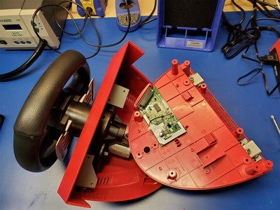

Reply 24107 of 27685, by Shponglefan
I did some more testing of the pedals.
The pots are providing variable resistance and there is continuity through the attached cable.
In testing, the brake pot ranges from 3.37 kΩ (unpressed) to 5.83 kΩ (pressed). The accelerator ranges from 6.48 kΩ (unpressed) to ~13 to 22 kΩ (pressed).
I also experimented with swapping to the two pots around (i.e. swapping the accelerator pot for the brake pot). That had no effect on testing with driver software as the brake still shows being 'stuck' as max pressed, whereas the accelerator works as expected.
I further disassembled the wheel itself and looked at the controller. The lines for the pots specifically go straight to the microcontroller on the board. Physical inspection of the board showed no obvious issues. Continuity tested fine and there also don't appear to be any shorts.
I figure at this point if the pots are fine, then it may be an issue with the microcontroller or possibly a software calibration problem? I may also try testing the supplied voltages as well, though without knowing the voltages should be, I'm not sure how much that will help.

Reply 24108 of 27685, by Shponglefan
TheAbandonwareGuy wrote on 2023-04-01, 04:52:
BitWrangler wrote on 2023-04-01, 05:00:
The pots are providing variable resistance. Even swapping the pots around didn't change testing software: no response from the brake pedal, but the accelerator pedal worked fine.
My feeling is there is either a problem with the voltages being supplied, a problem with the microcontroller, or maybe just a software calibration issue.

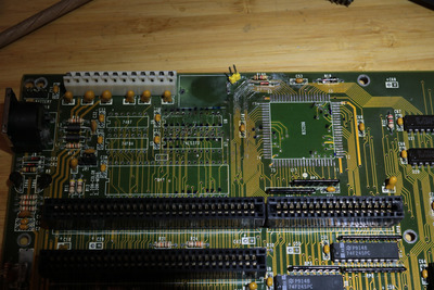

Today I set out to fix a KVD 486 board that kept showing a "Keyboard error".
Since I am still quite new to this, I watched some videos on how to check for broken/corroded traces etc. However, the board is in pretty good condition, since it came with the infamous Dallas chip, so no corrosion from battery acid.
After checking some traces from the keyboard connector with no result, I decided the check the connector, while the power was on and quickly noticed that there was not power on the 5V pin.
Checked for continuency along the 5V rail and sure enough, it stopped at a "bridge" that turned out to be a fuze. Just to be sure that this was the only problem, I did a little McGyver and used a paper clip to bridge the fuze 😀
97.39 KiB
1333 views
And yeah, that was it. Board booted up all nicely 😀

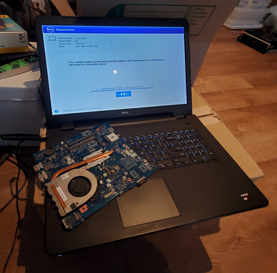

Reply 24112 of 27685, by Kahenraz
Fixed a Dell Inspiron 5555 today. Not really retro. Just old.
It was as easy as a motherboard swap, and this laptop is very easy to disassemble. The old board had a short on it. When connecting to power, there would be an audible popping sound, and the LED on the power brick would go out. Unplugging and replugging the brick brings it back to life.
Swapped out the motherboard and it works like a charm.
1.1 MiB
1306 views
