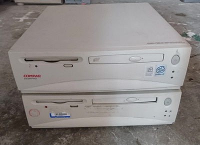

Wolfus wrote on 2020-06-01, 09:06:
Another tiny compact in for my collection 😀 Just fond this little beauty (well it was not a beauty when I found it - coffe was spilled into/over it many years ago and it needed lot of cleaning) at local scrapper's yard. I love it's design. Just a few clicks and whole computer is disassembled. Well, not just a few if some halfwit spilled oversugared coffe into case which sticks chassis with MOBO drawer together... And it has ESS1868 onboard! I think I won't put any cards into it, only some RAM for onboard ATI.
What bothers me is missing CD-ROM cable. As you can see, it has some proprietary connector on board and that slim drive is classic notebook one with add-on with the same 50-some pin connector. I have no idea where to find suitable cable.
Maybe just swap out the drive... or I bet if you take those 2 screws out, that little back cover comes off and the weird proprietary adapter comes off as well and then drive may actually use the standard style connector underneath.. such as this adapter:

Reply 2745 of 4961, by Wolfus
cyclone3d wrote on 2020-06-01, 19:22:
https://www.ebay.com/itm/IBM-49P2738-CD-ROM-J … 6m/281169598627
Nice, maybe I'll buy that adapter, thanks! Or maybe I'll use PCI SATA controller and modern slim drive and SSD 😳
I know, I know 😉
PC Hoarder Patrol wrote on 2020-06-01, 17:48:
Good luck finding that cable - seems it only existed as part of a complete kit (314215-001) and has been an expensive rarity for years.

Reply 2746 of 4961, by andrea
Trayload G3 iMacs also used a 50 pin cable for CD, part number 922-3594. Perhaps this will be easier to find.
PS: I've never seen one of those, so I don't know if it's a regular straight cable or if if has twists or other weird things.
You can also find 50p 2.0 mm pitch ready made cables from china on eBay. Hopefully Compaq hasn't done Compaq things and it will work with a regular cable.
Reply 2747 of 4961, by chinny22
Wolfus wrote on 2020-06-01, 20:04:
I know, I know 😉
Both the above are good options, Alternatively just use a standard CD drive plugged into the IDE cable during initial setup with the top off.
Once you have networking up and running you probably wont miss having a working CD drive anyway.
