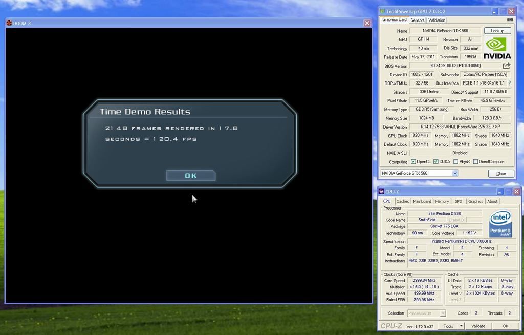

Pentium D 830
Because I used the stock HSF from a C2D E6600, I couldn't overclock any of my Pentium D CPUs. Heck, I had to undervolt this processor just to get it to finish the synthetic CPU tests without throttling. It's insane how hot these things get. Even when it's undervolted, the Pentium D runs hotter than a C2D E6600 overclocked to 3GHz! 😲
At 3GHz/800FSB, the Pentium D managed to beat my P4 520 at 3.73/1066. Doom III's dual core support works quite well!
Windows 7:
Pentium D 830 @ 3GHz/800FSB, GeForce GTX 560 (341.44), 8GB DDR2-800 5-5-5, Asus P5N-E SLI (nForce 650i), X-Fi Ti, Win7 x86
Windows XP:
Pentium D 830 @ 3GHz/800FSB, GeForce GTX 560 (341.44), 8GB DDR2-800 5-5-5, Asus P5N-E SLI (nForce 650i), X-Fi Ti, XP SP3
"A little sign-in here, a touch of WiFi there..."

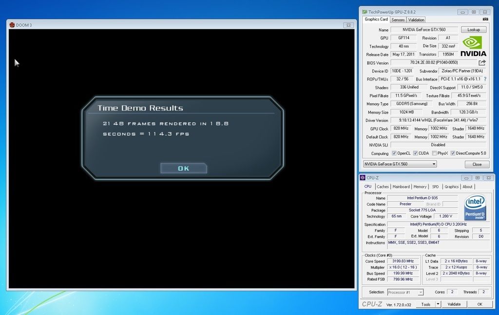

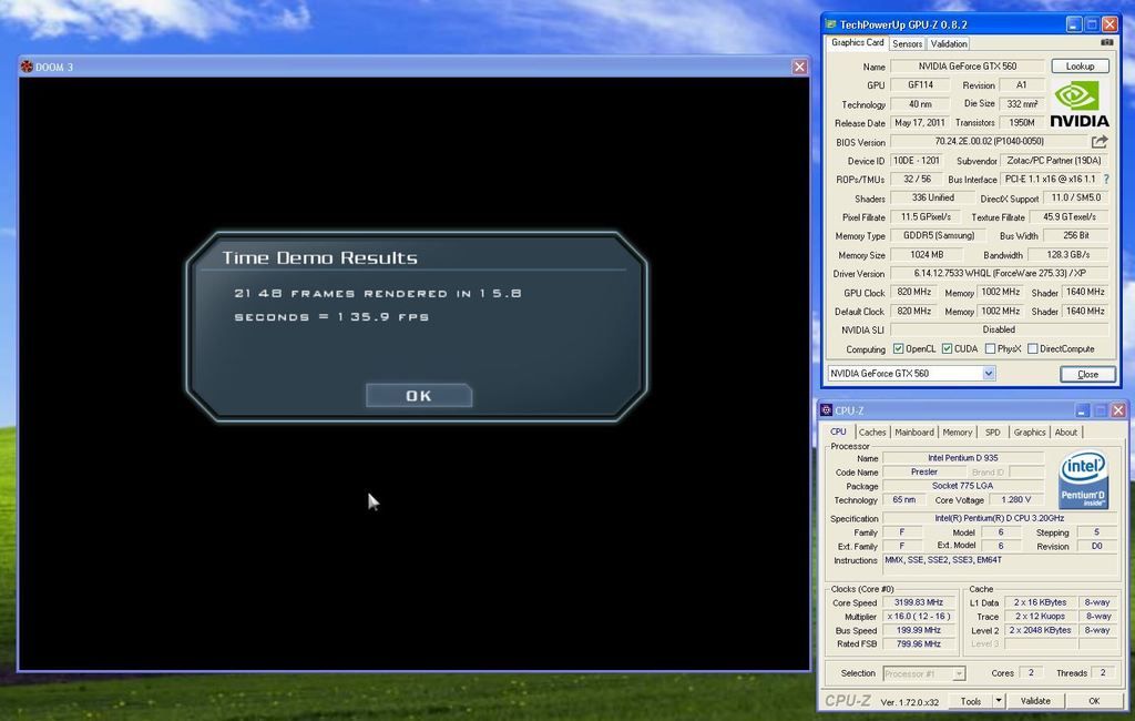

Some more Pentium D goodness--this time with a PD-935. This one has twice as much cache as the 830 (4MB L2), is clocked 200MHz higher, and runs cool enough that I can operate it at stock voltage with the C2D's stock heatsink. No overclocking though. 😢
Actually, I'm kind of surprised at the results. These numbers aren't half bad. It still sucks at 3DMark 01/05/06, though.
Windows 7:
Pentium D 935 @ 3.2GHz/800FSB (4MB L2), GeForce GTX 560 (341.44), 8GB DDR2-800 5-5-5, Asus P5N-E SLI (nForce 650i), X-Fi Ti, Win7 x86
Windows XP
Pentium D 935 @ 3.2GHz/800FSB (4MB L2), GeForce GTX 560 (275.33), 8GB DDR2-800 5-5-5, Asus P5N-E SLI (nForce 650i), X-Fi Ti, XP SP3

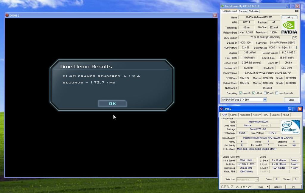

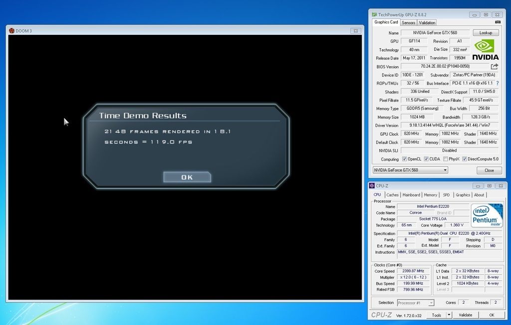

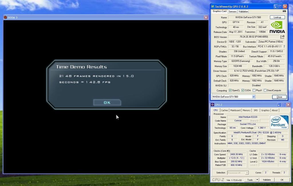

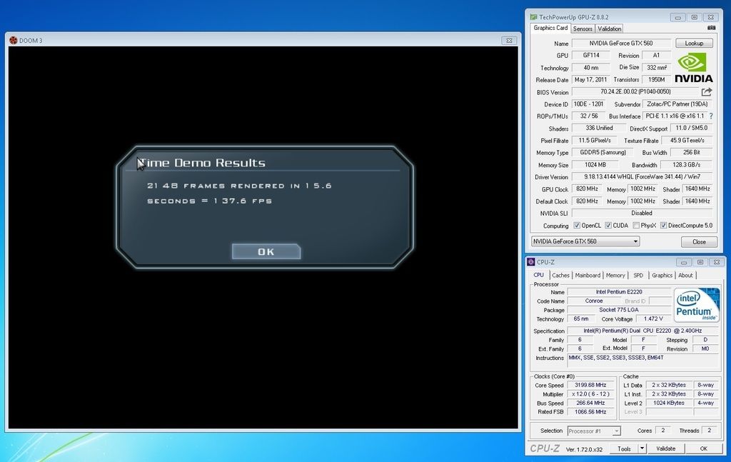

Looks like Doom3 is also sensitive to cache size. Here's the 1MB Pentium E2220, tested at 2.4/800 and 3.2/1066. Despite being based on Core 2, at stock speed it is only a few frames faster than the Pentium D 935, and is quite a bit slower than the K8-based Opteron 185, clock for clock. When overclocked, it easily leaves the P-D in the dust, but still can't catch up with the Opteron.
Windows 7:
Pentium E2220 @ 2.4GHz/800FSB (1MB L2), GeForce GTX 560 (341.44), 8GB DDR2-800 5-5-5, Asus P5N-E SLI (nForce 650i), X-Fi Ti, Win7 x86
Pentium E2220 @ 3.2GHz/1066FSB (1MB L2), GeForce GTX 560 (341.44), 8GB DDR2-800 5-5-5, Asus P5N-E SLI (nForce 650i), X-Fi Ti, Win7 x86
Windows XP:
Pentium E2220 @ 2.4GHz/800FSB (1MB L2), GeForce GTX 560 (275.33), 8GB DDR2-800 5-5-5, Asus P5N-E SLI (nForce 650i), X-Fi Ti, XP-SP3
Pentium E2220 @ 3.2GHz/1066FSB (1MB L2), GeForce GTX 560 (275.33), 8GB DDR2-800 5-5-5, Asus P5N-E SLI (nForce 650i), X-Fi Ti, XP-SP3

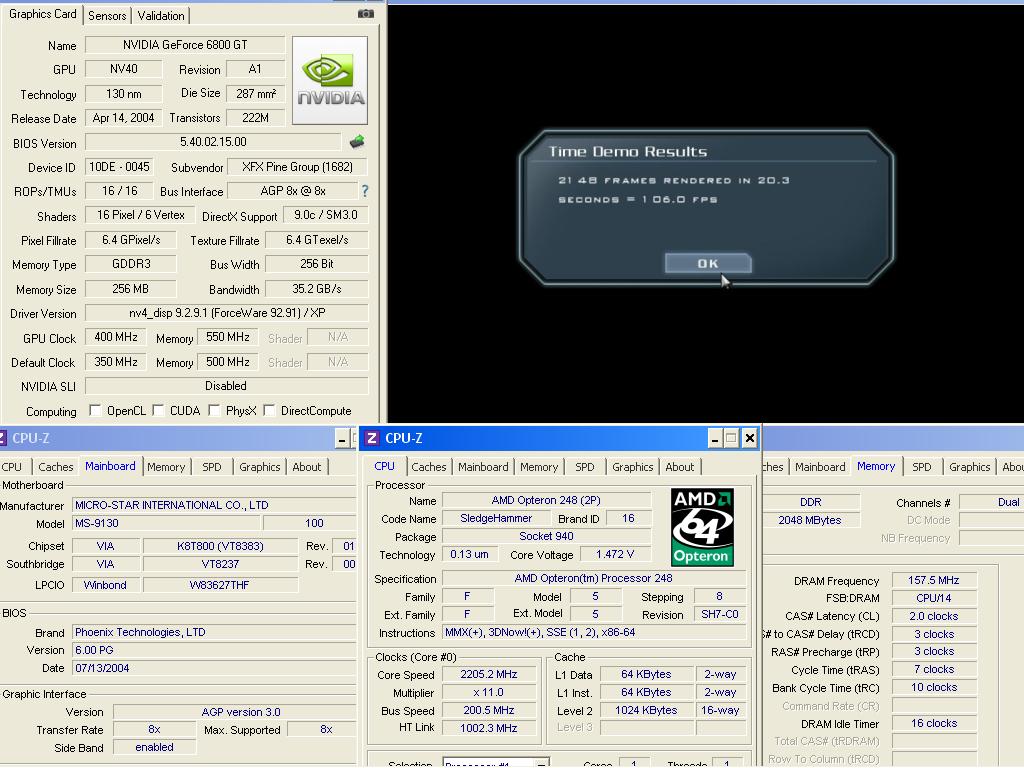

This system only beats the FX55 system because of the older Doom 3 version used. Once I manage to test the FX55 with the older version I expect it to regain the top position.
2x Opteron 248 2.2GHz Sledgehammer, MSI K8T Master2 FAR, 2GB DDR157 CL2-3-3-7, 6800Ultra 92.91, onboard audio, XP-SP3
1024*768 Ultra: 106.0 FPS

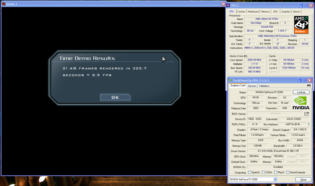

Ever wonder how well Doom 3 runs on a Titan X? I certainly do. Here's an FX5200.
Athlon 64 3700+ @ 2.64GHz, GeForce FX 5200 128MB/64-bit (81.98), 2GB DDR-400 CL2, Gigabyte K8NSC-939, onboard audio, XP SP3
640x480 Medium: 19.0 fps
1024x768 Ultra: 6.5 fps
1280x1024 Ultra: 4.5 fps
