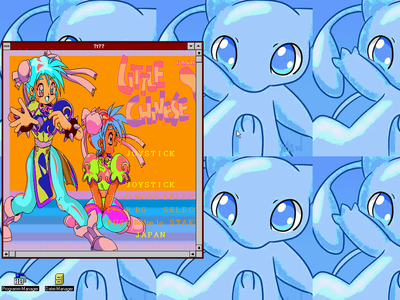

Here's something for you that I've intended to keep as a Christmas present for you!

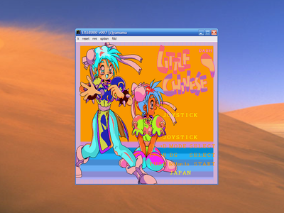

- It's a Sharp X68000 emulator from the 90s that runs on Windows 3.1+Win32s, too.
All in all, it was a lot of work to discover, it took me weeks of searching the internet and testing executables.
The emulator itself is in an early stage, but already usable for visual novels, disk mags and puzzle games.
So definitely fun to toy with on your vintage PC ("Hey! Look! X68000 games on my 486 beige tower!"). ^^
Please note that some games require a joystick, which I think the emulator doesn't emulate.
So you need a real joystick attached to your Windows PC. On Windows 3.1, that IBM Joystick applet might be needed, not sure.
To actually run games, you must convert them to the XDF format by using a freeware utility.
Since the menu bar is somehow missing in Windows 3.1+Win32s, just edit the config file manually and run the emulator.
It looks like this:
EX68000 option setting.
4,1,0,2,1,1,1,1,0,1,1,1
little.xdf
no disk
no disk
no disk
Merry Christmas time to you
and a Happy New Year! ^^
Edit: Typos fixed.
PS: The Mew wallpaper was found on DA.. I'll add credits once I remember them again.
Edit: The format of the config file is like this, I believe:
4,fpu,speed,aspect,stick,adpcm,piority,vsync,palette,midi,2fdd,mouse
Maybe this is useful to you if you're on a pure Windows 3.1x PC and would like to edit the config manually.
    80.95 KiB
    3012 views
    Game "Little Chinese Dash" (Win32s)

    Game "Little Chinese Dash" (XP)

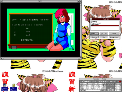

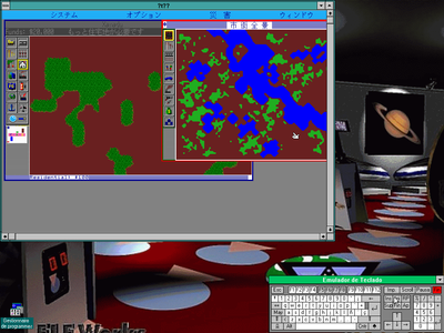

Quick update. The X68k emulator works on Windows 3.10+Win32s, but you may not be able to use the keyboard.
If that happens to you, you can try to regain focus by using task list (double click the background).
Once open, choose the emulator and push the button labeled "cascade" (or "tile").
The emulator window will now be active again (be in foreground).
As a proof of concept, I've added a screenshot of the game Minami No Hiroshi No Eigo Kyoushitsu.
It's sort of a Hentai quizz game that tries to teach English lessons. Input is done via Enter key and number keys.
If you're on plain Windows 3.1, you can also install MS Mouse 9.x driver floppy (has Windows installer).
It includes a better Mouse/Keyboard driver combo for Windows that goes away with jumpy mouse problems.
Hope that helps! ^^
Edit: I forgot to mention. I'm also running Teclado here, the virtual keyboard.
It seems to fix the message loop issue (?) that goes along with the focus problem.
Once the X68000 emulator window is in foreground, the physical keyboard works.

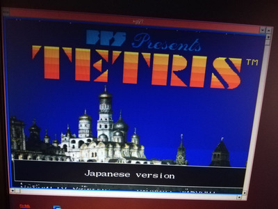

Edit: Tetris runs on real hardware (photo attached).
    111.66 KiB
    2685 views
    Tetris

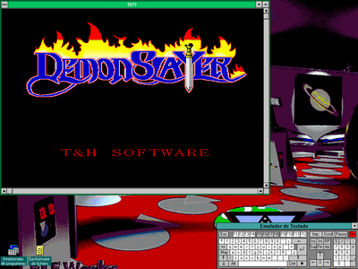

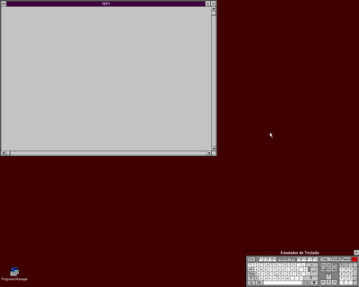

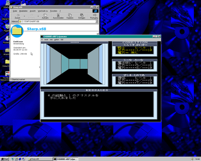

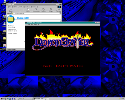

Quick update. While playing Demon Slayer for the X68000, I noticed something interesting.
There's a glitch causing the Windows 3.1 "overlay" graphics to crash.
The crash doesn't happen with Windows XP (natively) or Windows 95 in DOSBox.
On Windows NT 3.x, it seems to be fine, too.
I'm not sure what exactly causes this problem.
Could be related to the S3 graphics driver, too, or the S3 graphics acceleration features.
I've attached some screenshots for you. 😀
PS: I'm amazed how toug this early emulator is, despite not being feature complete yet.
It's over 25 years old, after all. The game plays fine via numpad, by the way.
    83.97 KiB
    2695 views
    Demon Slayer! (EX68k on Windows 95)

    The emulator loses output on Windows 3.1x (grayed out)

    Amazing mazes (no garbled graphics/text)

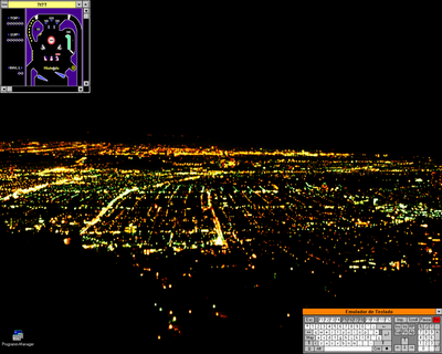

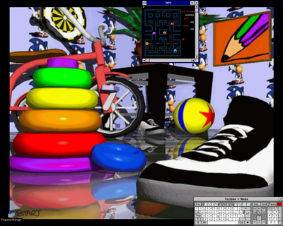

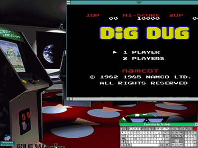

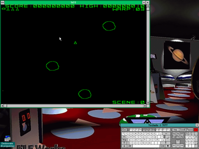

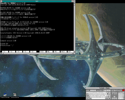

Quick update. Here are a few screenshots of some playable games, taken in DOSBox (running Windows 3.1+Win32s)..
Break Down is a memory game from '89, it can be played with the numpad/space bar and requires no Kanji/Kana skills.
In case you're curious, you can compare the emulation with the real thing (X68k+CRT) over here.
    292.14 KiB
    2685 views
    Human68k system disk

It's really hard to find something interesting from Japan that doesn't try to be, um, graphically arousing in some way. 😉
Unfortunately, the fighting/shmups games which are less cutesy-looking don't really work so well in early emulators.
They do use a lot of graphical tricks. Sprites, collision-detecting, parallax scrolling, multiple graphic layers etc.
Edit: Text edited. Text re-formatted.
Edit: Some screenshots added.
Edit: These games aren't exactly "western" games, but they're rather familiar.
    79.5 KiB
    2613 views
    Asteroids
    90.96 KiB
    2613 views
    Dig Dug
    91.96 KiB
    2613 views
    Sim City for X68000

Quick update. I have found something out!
The graphical glitches are related, at least partially, to the S3 graphics that I use both in DOSBox and on the Pentium 133 PC.
My gut feelings weren't so wrong, after all. As it turns out, EX68k itself is perfectly fine with the Super VGA drivers that come with Windows for Workgroups.
Even the ancient 16 colour Super VGA driver from Windows 3.10 ('92) is okay, depending on what the game demands!
Now isn't that awesome!? 😁
Even with a bog standard ISA VGA card (a simple frame buffer), EX68k was usable in the 90s! 😎
- The fact that Windows 95 was likely used instead in practice doesn't change that.
Screenshots attached.
    14.99 KiB
    2630 views
    Game "Asteroids" (supervga.drv; Super VGA 800x600 16c)

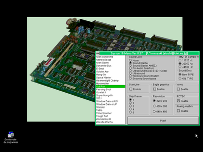

Quick update. There's still some more Windows 3.1x emulation software to come, please don't worry.
Here's System16 Menu, a Windows front-end for SYSTEM16 emulator.
System 16 was an arcade system by Sega, which hosted popular titles, such as Outrun or Fantasy Zone.
It also was the basis for the Sega Genesis (Mega Drive), though the console ran at a lower speed (7 MHz vs 10).
In the attachment, you'll find a small package, consisting of the front-end and the emulator.
It also comes with source code, since it was published on the official homepage.
Due to the uncertain age of the front-end ('98 ?) I wasn't sure which exact emulator version was required.
So I added a couple of them, in the hope that one of these matches.
    67.41 KiB
    1432 views
    Wall paper: https://commons.wikimedia.org/wiki/File:Fantasyzonepcb.jpg
