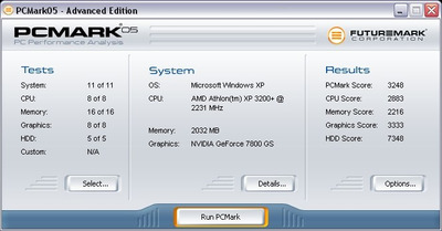

The final version of PC mark tested is 2005:
Reply 282 of 1179, by nd22
Individuals scores look as follows:
CPU are so close we can not declare a winner!
nforce2: 2921 - 100%
KT880: 2844 - 97.36%
KT600: 2883 - 98.69%
RAM - KT600 is again in last place!
nforce2: 2354 - 100%
KT880: 2267 - 96.30%
KT600: 2216 - 94.13%
GPU - this time there is no more doubt about the winner, nforce2 scores a clear victory; what is worse is the score of KV7/KT600 which is over 10% behind its bigger brother!
nforce2: 4180 - 100%
KT880: 3799 - 90.88%
KT600: 3333 - 79.73%
PC mark shows us that nforce2 keeps the lead; however an even bigger problem are the disastrous memory and graphics scores for the KT600 platform!

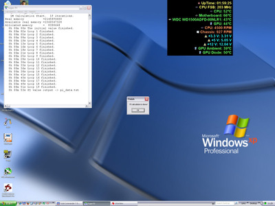

We are now going to test Super pi 1m, to see if CPU performance differs when using the KT600 chipset:
Reply 284 of 1179, by nd22
A lower score is better so let's compare:
nforce2: 49 sec - 100%
KT880: 52 sec - 93.88%
KT600: 53 sec - 91.84%
nforce2 is the quickest and secures another victory!

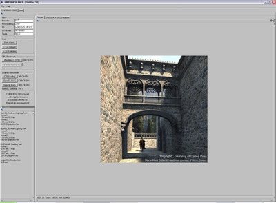

Cine bench 2003 is next:
Reply 286 of 1179, by nd22
KT600 has the highest score out of the 3 platforms but below the 5 % limit of error so still no clear victory for Abit KV7!
nforce2: 254 - 100%
KT880: 249 - 98.03%
KT600: 266 - 104.75%

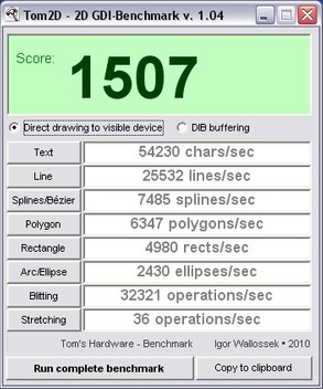

We have now arrived at the final synthetic benchmark: Tom 2d!
Reply 288 of 1179, by nd22
This is not a mistake! There where no other programs running during this test! I repeated it many times; in fact I did not put the results on Sunday because that evening I took the spare KV7 out of storage, assembled everything using the second board, installed Windows XP and ran again Tom 2d several times!The result remain just as bad!
nforce2: 42613 - 100%
KT880: 31483 -73.88%
KT600: 1507 - 3.53%
KT600 is crushed and turned into fine dust! Abit KW7/KT880 score is bad but Abit KV7/KT600 score is abysmal, there is no other way to put it! GUI performance on KT600 chipset is horrible! KT880 improves enormously upon its predecessor but still is far behind nforce2! As for Abit KV7 this is the worst result in this comparative and the final score will be influenced a lot by it!
I must thank swaaye for suggesting this benchmark back in 2018 when I started this project!

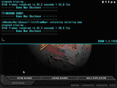

For the final test only one game remains: Doom 3! Heavily GPU bound I disabled AA in order not to overwhelm geforce 7800gs which is too weak to play this game at max settings!
1024*768
Reply 294 of 1179, by nd22
VT1616 shows once again Sound storm is not something to be afraid of! KT880 lags behind because of ALC650 very high CPU utilization!
nforce2: 48.3 fps - 100%
KT880: 44.2 fps - 91.51%
KT600: 48.5 fps - 100.41%

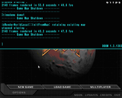

We go up to 1280*1024:
Reply 296 of 1179, by nd22
One more time the audio codec used by Abit in KV7 makes up for the difference and KT600 is the equal of NFORCE2!
nforce2: 47.0 fps - 100%
KT880: 43.5 fps - 92.55%
KT600: 47.5 fps - 101.06%

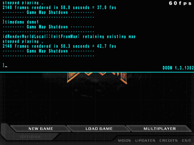

And the final test at 1600*1200 resolution:
Reply 298 of 1179, by nd22
Doom 3 has no winner! Both KT600 and nforce2 ultra are too close to each other to claim victory! KT880 is let down by the Realtek codec. Does anybody know a motherboard with KT880 chipset using VIA VT1616 or similar audio codec? In my opinion such a board would outperform nforce2 ultra!
nforce2: 42.9 fps - 100%
KT880: 40.8 fps - 95.10%
KT600: 42.7 fps - 99.53%
