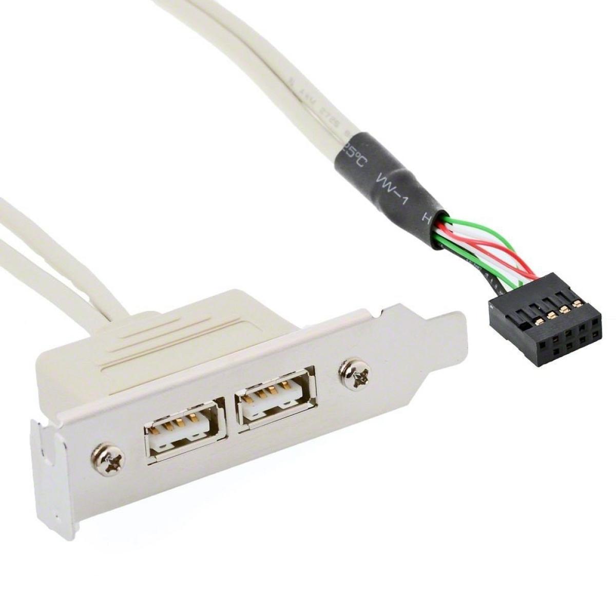

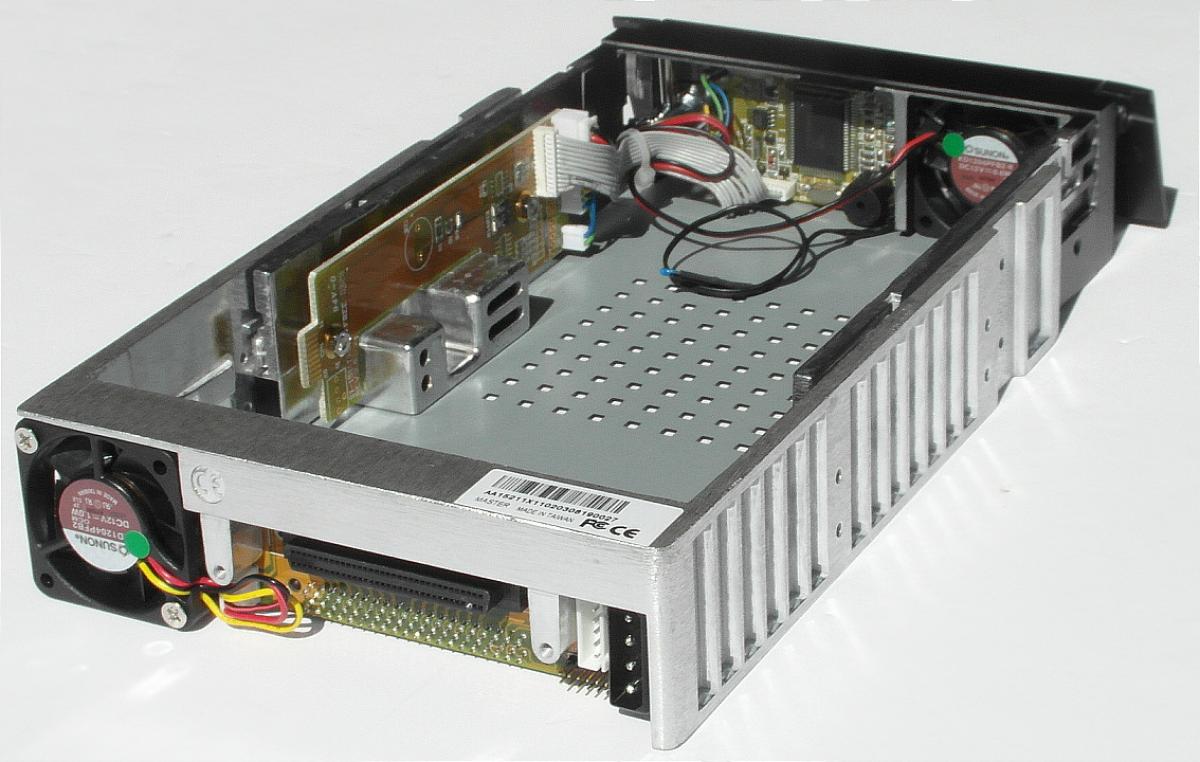

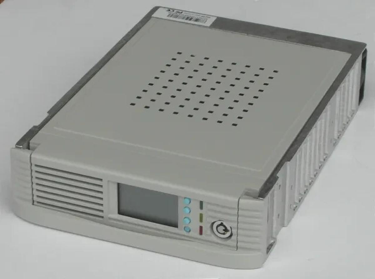

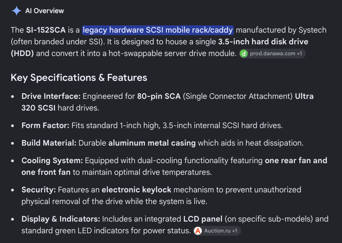

I've just ordered this 68-pin SCSI Removable Drive Rack to house the System Disk:
Here are its specs:
And I've also purchased this USB header, which will fit into one of the open parallel port openings on the rear of the case:
YouTube
