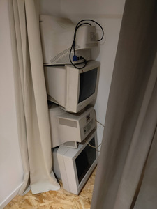

JustJulião wrote on 2025-03-15, 21:24:
Traveled 80kms to pick several CRT monitors for free.
Unfortunately, the bottom one, a 21 or 22", turns on but doesn't display anything.
The attachment IMG20250315221920.jpg is no longer available
Looks like a Sony Trinitron build (and FWIW, Viewsonic did use Sony as the OEM for some of their monitors, among others.)
First thing to check is for bad solder joints on the power board - particularly for the the heater, B+, and around HV-drive areas. Speaking of which, does the monitor make that "static electricity" noise during power up? If not, then that might suggest the high-voltage drive is not working. On late Trinitrons, HV drive is separate from HOT from what I remember.
On the other hand if you do get the static electricity noise to indicate the HV is coming up, then a missing heater voltage could be the source of no picture.

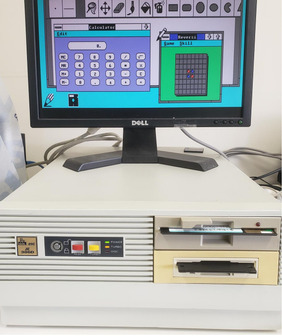

I finally finished my pre DOS 6.22 / Win 3.1 machine.
I explicitly wanted to get a genuine impression of how these earlier itterations feel
- real EGA
- DOS 3.3
- Win 2/386
- NC3
- original Paintbrush
- lots of other early windows stuff -fascinating!
