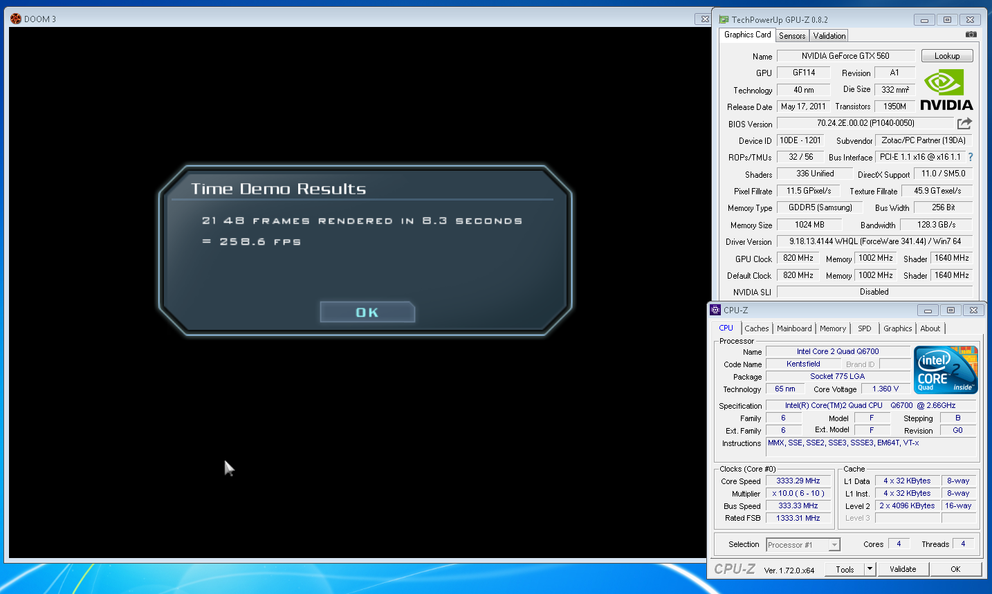

Now we're cooking with gas! Here's the trash picked 775 system in its final configuration, with a Core 2 Quad and a fresh install of Win7 x64. This machine will probably handle basement HTPC duty.
I'm not entirely sure why, but the Quad seems to be much faster clock for clock than the C2D E6600, at least in Doom3. The E6600 @ 3GHz was only pushing 180.6 fps under Win7 and 228.5 fps under XP. I also noticed that the memory score in Windows Experience Index shot up after I installed the Quad (from 5.5 to 7.3), although that may be because Win7 x64 can actually use all 8 gigabytes of RAM (I was using the 32-bit version of Windows with the other CPUs I tested).
Core 2 Quad Q6700 @ 3.33GHz/1333FSB (8MB L2), GeForce GTX 560 (341.44), 8GB DDR2-800 5-5-5, Asus P5N-E SLI (nForce 650i), X-Fi Ti, Win7 64.

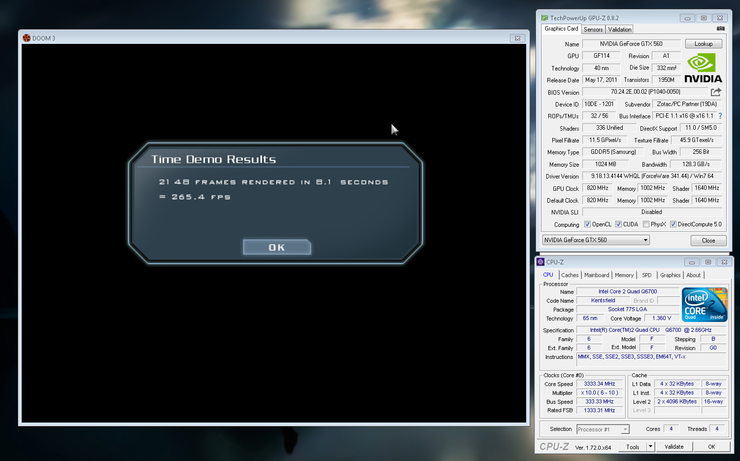

I was able to wring a little more performance out of the q6700 by tightening up the memory timings. Turns out that 667MHz @ 4-4-4-12-1T is faster than 800MHz @ 5-5-5-12-2T.
Core 2 Quad Q6700 @ 3.33GHz/1333FSB (8MB L2), GeForce GTX 560 (341.44), 8GB DDR2-667 4-4-4-12-1T, Asus P5N-E SLI (nForce 650i), X-Fi Ti, Win7 64.

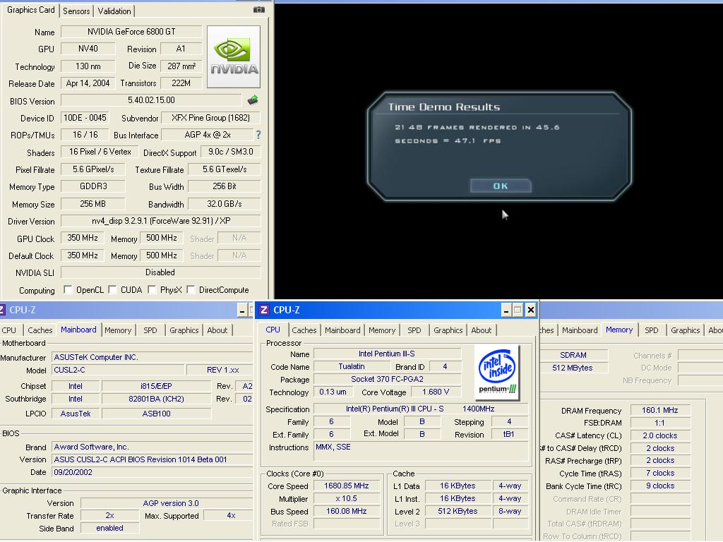

I did finally test a Pentium 3 system.
The BIOS that let me run AGP 4X overclocked wont overclock as far as the latest official beta BIOS. The difference between AGP 2X and AGP 4X is small so its not a huge issue. Steves system with DDR memory is faster but if only someone could mod the better CUSL2-C BIOS to enable AGP 4X with overclocked settings I think I would get close 😀.
1024*768 Ultra
Pentium III 1400-S @1575MHz, CUSL2-C i815, 512MB PC133@150MHz CL2-2-2-7, Geforce 6800GT 92.91 AGP2X, SB Live, XP-SP3.
Pentium III 1400-S @1575MHz, CUSL2-C i815, 512MB PC133@150MHz CL2-2-2-7, Geforce 6800GT 92.91 AGP4X, SB Live, XP-SP3.
Pentium III 1400-S @1680MHz, CUSL2-C i815, 512MB PC133@160MHz CL2-2-2-7, Geforce 6800GT 92.91 AGP2X, SB Live, XP-SP3.

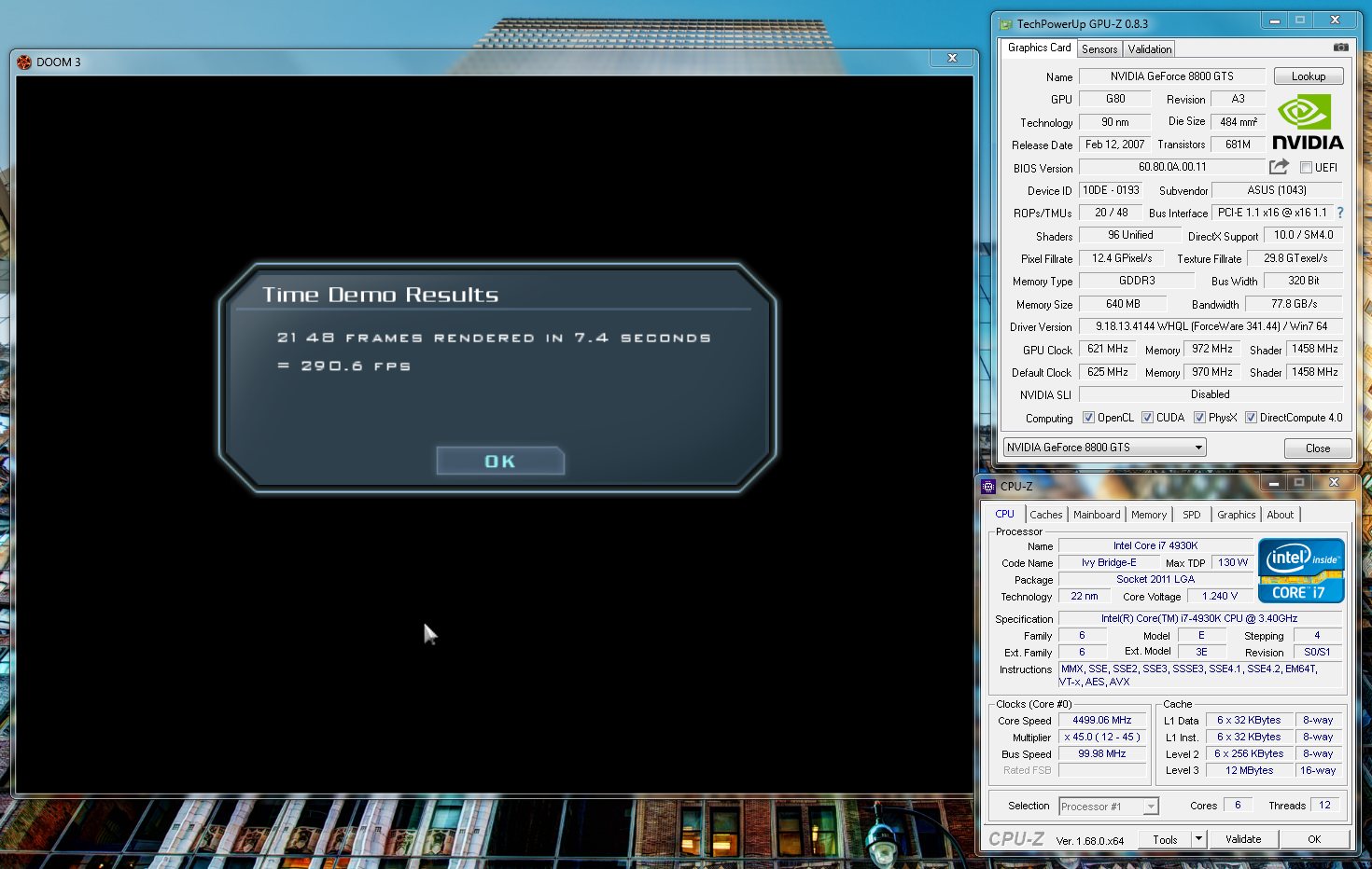

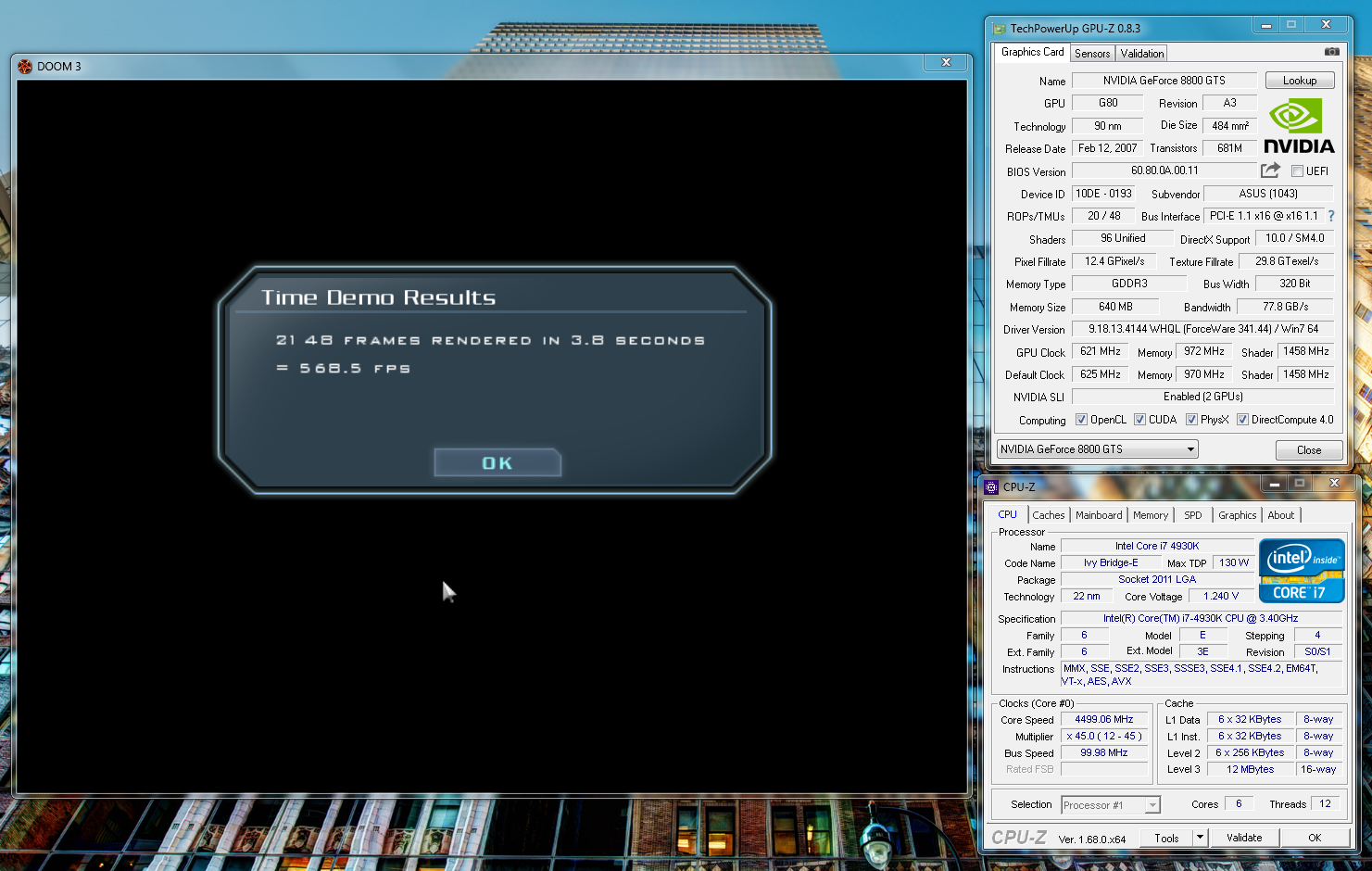

Back in 2007 when I was using an Opteron 185 as my main system, adding a 2nd 8800GTS barely improved the performance of most games, even at 1600x1200. Fast forward to 2015, throw more processor ponies at the situation, and SLI pretty much doubles the performance, even at ridiculously low resolutions like 1024x768.
i7-4930K (4.5GHz/1.25v), 32GB DDR3-2133 9-11-11-1T (1.55V), Asus Rampage IV Gene, onboard audio, Win7-64
Single 8800GTS 640MB (341.44):
1024x768 Ultra:
8800GTS 640MB SLI
1024x768 Ultra:
"A little sign-in here, a touch of WiFi there..."

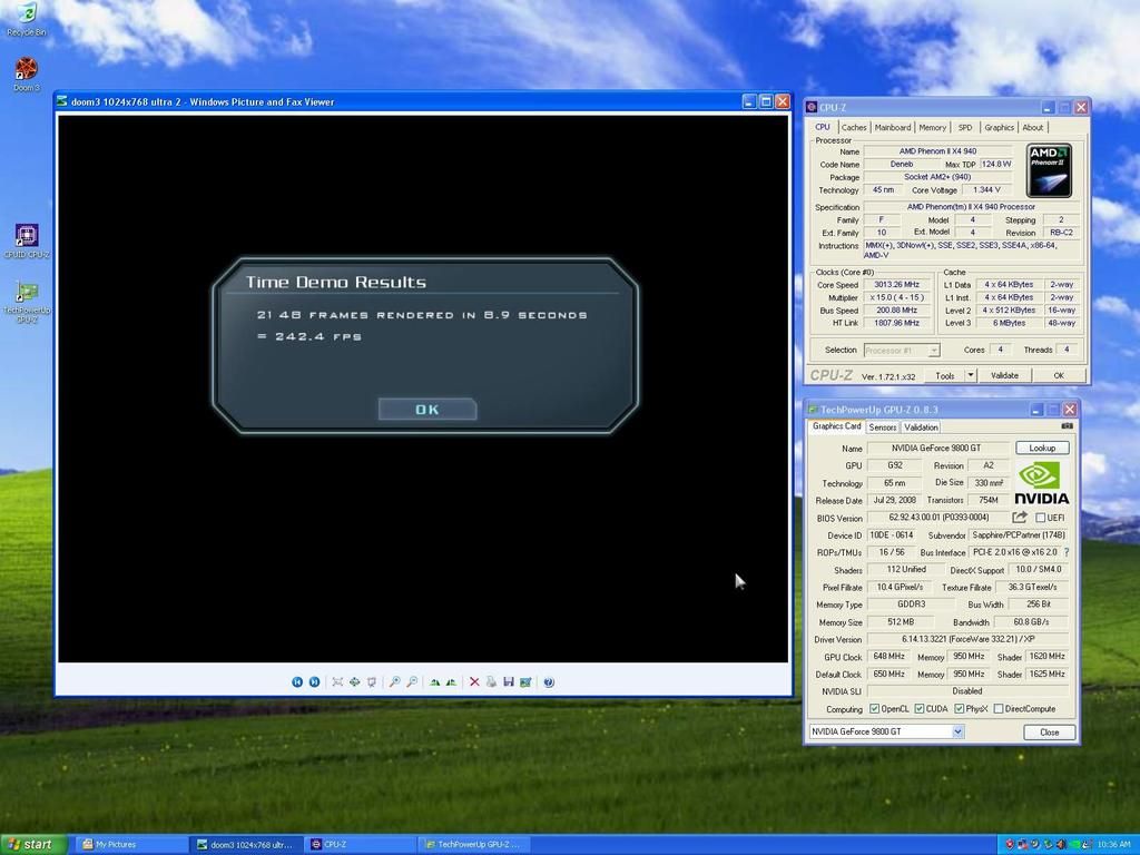

Here's your first Phenom result. I just got my AMD Phenom II x4 940 up and running with XP Home SP3. Using 332.21 (the earliest on Nvidia's website) with a 9800 GT. 4GB of DDR2 667. I don't know how to display memory timings, so I took a photo of my BIOS screen. Doom 3 is retail version 1.0.1262.

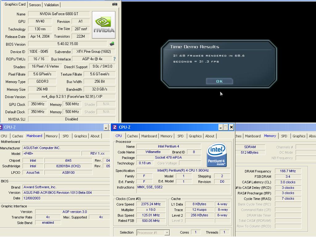

A Willamette P4 is not a good CPU for running Doom 3...
1024*768 Ultra: 31.3 FPS 😁
P4 Willamette 1900@2375MHz, Asus P4B i845, 512MB PC133@166MHz CL3-3-3-7, Geforce 6800GT 92.91, onboard audio. XP-SP3
