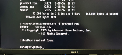

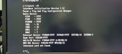

So I have finally built my Argus, but it's not detected by pnpmap on my 486 66mhz. I have installed the ICU dos driver from the discussion I have found here: Re: How do you install the GUS PnP drivers in a 486/DOS pc?, but pnpmap does not seem to like it. Do I have to try a different computer to program it or are there things I can still try?
Reply 3145 of 3174, by TheMobRules
You're supposed to run PNPMAP before any PnP initialization is done, because that utility is what actually programs the EEPROM on the card with the required PnP data. Only after that is done you can turn off and restart the PC and the card will be either detected during POST (if you have a PnP BIOS) or by any ICU that you run from DOS.
If PNPMAP does not detect the card at all you can start by checking the soldering on the little EEPROM chip that PNPMAP tries to program (U30 if I'm not mistaken). Try and follow the traces coming out of it to see if you can spot any issues. You can also post some pictures of your card so other people here can try to find if something's not right.
Reply 3146 of 3174, by bnz99
Yes, I have only been loading that ICU driver once nothing worked. There was no PNP initialization beforehand. The 486 doesn't have a PNP bios anyway. So I just switched my 486 with my Pentium-233Mhz MMX and this board could run pnpmap without any problems. After the cold start, the bios could see the ultrasound in POST as you describe. Impulse Tracker and a bunch of demos work fine and make perfect sound. So it seems I have managed to build it without much drama 😉 I just have to figure out how that GF1 compability mode works, some demos don't make sound.
Edit: it's all working, including demos etc. once I got my iw.ini and plug&play configuration correct. So happy to finally have a GUS again 😀

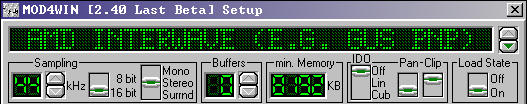

I finished assembling my arGUS and using IWAVECFG.EXE I could copy it's pnp configuration from the GUSPnP and swap it back and forth to test it. The first thing I noticed is how noisy the GUSPnP was when it get initialized. So I though it was related to a mixer setting, the culprit on the GUSPnP is the "advanced/synth" fader of MIXER.EXE. Obviously the synth being the main event of any GUS, it's the last one you want to disable. So it's really the arGUS that got this right, I wonder from what magic this is being possible. I have a GUSPNP 3.0 so maybe there is some wiring problem on that version. I read before on the forum other users mentionning how clearer the arGUS is but I was assuming some placebo effect, now I reckon there is no misunderstanding !
I havent found if the onboard rom could be used when using a 16mb soundbank file, but I realize it's quite difficult to test for the gain of doing it. I'm now just glad I can listen to my video game music midi collection with the arGUS 16mb onboard using Utopia full stereo 16bit. Many would not load on the GUSPnP 8mb. Just this make it all worth while.
I also quickly checked out MOD4WIN memory configuration and it display 1638, which is probably a most significant padding of 16384.

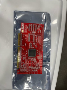

Reply 3156 of 3174, by TimWolf
Just picked this one up on eBay. What bracket do I need? Does anyone have them, or can I just take one off some other sound card?
Thanks in advance.
TW
