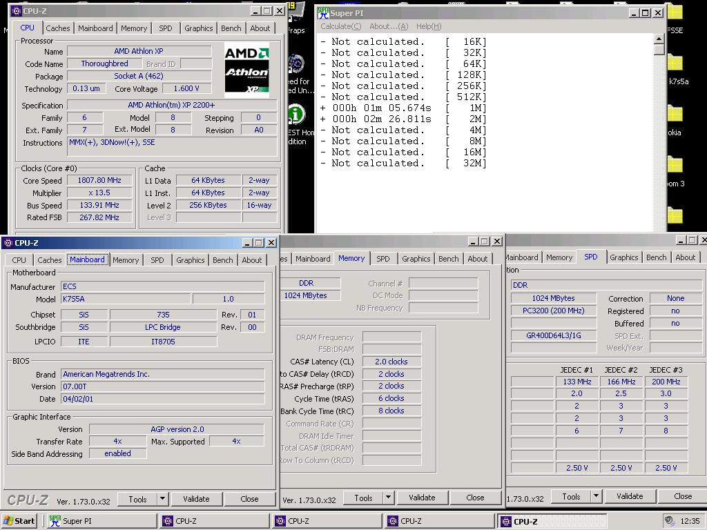

Reply 330 of 331, by Tom..
Athlon XP Thoroughbred 2200+ , SiS 735 ECS K7S5A ..
