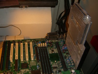

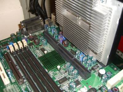

Close but no cigar. The board gets stuck at code "28" "initialization before setting the video mode is complete" the next step is "2A" "Bus initialization system, static, output devices will be done next, if present."
The behaviour is exactly the same with one or two CPUs, registered memory or normal memory, AGP or PCI video.
The board will not post with one or two 900 MHz 2M Xeons, at least not with this BIOS and I do not have any other Slot-2 CPUs to try. I think both the board and CPUs work? Without a CPU in the socket my diagnostic post code card shows nothing while with one or two CPUs it at least showns signs of life. The board does not beep though.
As always I ran in to some other issues.
This is not good.
The attachment fail.JPG is no longer available
Temporary fix.
The attachment workaround.JPG is no longer available

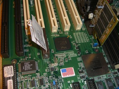

It also looked like some pins in the SCSI card slot might be shorting so I inserted a piece of paper.
The attachment another fix.JPG is no longer available
