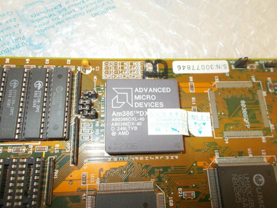

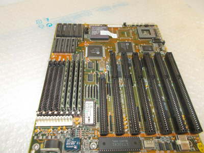

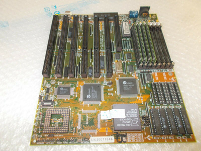

Purchased today a motherboard with CPU and RAM.
It is a motherboard for CPU 386DX, the CPU is an AMD 386DX-40MHz, the RAM is 30 PIN (8 banks tot.) Of 1MB each, in total there are 4MB.
I have some ISA cards aside, some VGA various controllers, and even some sound cards.
The card will be shipped in the next few days (provided the seller doesn't change his mind in the meantime), and should arrive within a few days.
It has a battery that should be replaced, the nearby area needs cleaning, the vendor says the card was working but hasn't started it for a while.

"for a while"? Probably more like a decade. If this board works with all the corrosion around the battery I'll eat my hat.
Get that battery of there asap. Then soak the whole area in white vinegar for a few minutes, then rinse thoroughly with IPA. Then check what the damage it.

Ok I hope in spite of everything it can work, thank you for the suggestion, I'll try to do as you say as soon as it arrives.
The seller did not specify how many years ago it was started, but I hope it was not damaged too much in the battery area and in the nearby ones.
For the rest if I can recover it, I'll try to find a co-processor, or at least I could change the CPU and FPU, putting a Cyrix 486DLC-40 and an IIT-40.

It's two banks of memory, 4 slots is one bank on a 386. Nice find though, I've been looking for a 386 socketed board at a sensible (for me) price.

Yes ok thanks.
You're right, it's two banks of four each, if everything goes well and works, I can put in another 4MB, so I would get a total of 8MB of RAM.
Probably this card supports RAM of higher capacity, for example those of 4MB each, unfortunately I have never had any and wanting to find them they cost a lot.
The cost was quite low, less than $ 15 (including shipping), but it remains unknown whether it is still working after years of inactivity.
