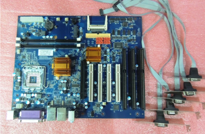

Hi all. Newbe here trying to build a retro pc. I kept all my old soundcards and my old 500gb IDE with all my games from way back when. I found this board on ALiexpress that says it has an ITE IT8888x bridge. It has 3 ISA sockets so my SCC1, GUS Ace, and AWE32 should work perfectly!! Has anyone tested this board out?
CYSMBD-G41-ISA +3 ISA +4PCI slots +1PCIe +6 COM-
https://www.aliexpress.com/item/32892452763.h … 3c00xYP3xt&mp=1

Reply 55 of 61, by The Serpent Rider
It has ICH7 south bridge, which is somewhat DOS and Win9x friendly, but ISA DMA is not supported since ICH5. ITE IT8888 bridge is supposed to emulate DMA, but I doubt that many (if anyone) actually bothered to implement that support in firmware on late motherboards.

This board has been discussed before. It doesn't support ISA DMA.
945ISA Motherboard - DMA... not working?

Reply 57 of 61, by MannyMania
fosterwj03 wrote on 2022-02-19, 19:49:
I hate to be a Debby downer, but i doubt a G41 board has ISA DMA. You can't get DOS sound effects without it.
Ok. I thought that boards with the an ITE IT8888 ISA Bridge were ok for compatibility. What alerted you that the board doesn't have ISA DMA.

Reply 58 of 61, by cyclone3d
MannyMania wrote on 2022-02-20, 04:00:
Ok. I thought that boards with the an ITE IT8888 ISA Bridge were ok for compatibility. What alerted you that the board doesn't […]
Thanks,
MM
The person in the thread I linked to bought one and ISA DMA did not work.
