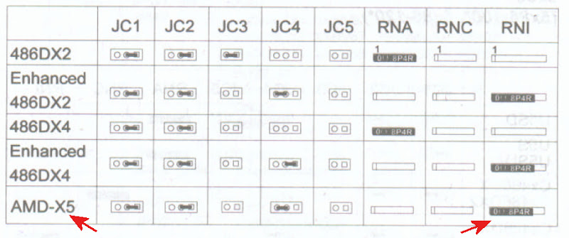

I have solved the issue I was having earlier, with the RNI 8-pin "jumper block". I found the manual for this FIC 486-PIO3 mobo. It's here. In it, there are these 2 diagrams:
Page 5
Page 6
For an AMD X5 (P75) CPU, the RNI 8-pin "jumper block" needs to be in pin holes 1-8, with pin holes 9 & 10 being empty. It was a good job I moved it, because it is now in its correct location. For a Cyrix CPU, the RNI 8-pin "jumper block" needs to be in pin holes 3-10, which is where it was originally located.
