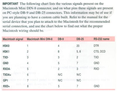

Here's a diagram scanned from the 630 DOS Compatible user manual describing the pinouts of Mini DIN-8 in relation to their DOS counterparts:
This means they are NOT identical, so no using of the working midi-connection on the mac-side!

Reply 42 of 94, by dr.zeissler
Would be very nice if some could confirm that. Then the only possible way is to use the softmpu serial connection with a correct wired cable.

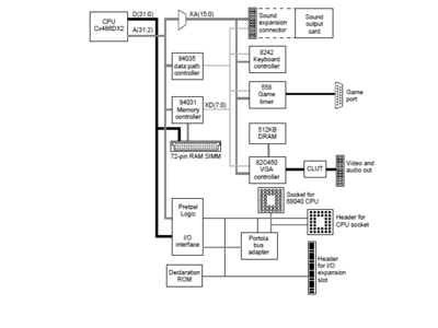

Edit: Never mind. Found a diagram. Seems only the NE558 connects to the Gameport..
Perhaps it can be fixed ? MIDI-out just needs two wires and a resistor.
Edit2: Be careful, 5v might be present on pin15 (MIDI-in)..

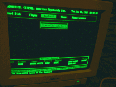

And here's the computer..
(Btw, just look at this computer's keyboard. Like that of a 70s terminal or 80s home computer.)

The Picture made it clear to me. The only way will be mapping the COM-Port to Apple-Modem-Port and using SoftMPU with COM-Output.
This already gave signals to the mt-32, but they sounded garbage. Perhaps not the right transferrate and the was another image in
the description of the 630dos that showed the differences between the com-port-wirings.

Your 630 incorporates a Vibra16s chip, the CT2501, which was also found on the "real thing" (certain SB16 cards).
Assuming the NE558 and Vibra16s do share a common ground, it is just a matter of finding a single pin on the chip,
then attaching a wire to it and adding a resistor (220 ohms, for example) between the wire and the Gameport (pin 12/15).
The real problem is, that there's no public documentation available - someone with a CT2501-equipped Vibra card
has to follow the traces on the PCB to make out this pin.. Maybe some forums members can help here ?
And the archetypal rebadged Philips monitor 😀
So many 80s computers used monitors from these series.
Oh my, you're right! One of my Hercules monitors is a Philips model and looks exactly like that one! 😳
84.95 KiB

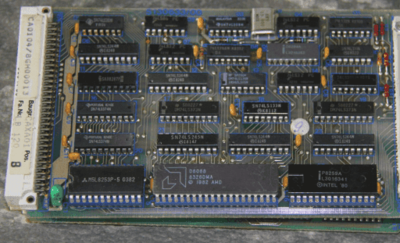

The 8088 card looked like this :
82.1 KiB
2534 views
http://forum.classic-computing.de/index.php?p … d&threadID=6547
