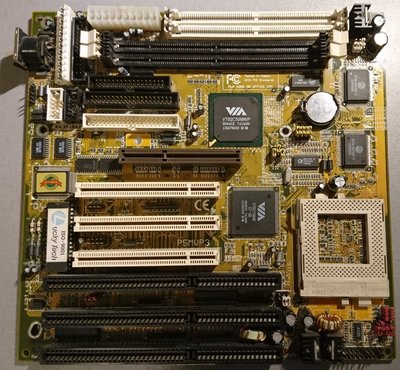

Kinda old, but I'd also suggest the SYE/LuckyTech P5MVP3 as a GOOD candidate. Overclocks well with a K6-2 500, has a very nice layout while being compact (and cute 😀 )
The attachment 286488589_882c4057-4f00-47ea-af38-26af755101f4.jpg is no longer available
512KB cache, supports most CPUs (including K6-2+ and III+), BIOS files can be found quite easily (including a HDD patched bios,BIOS string being 06/14/2000-VP3-586B-SMC6-2A5LESHDC-00) and is really stable.
Have owned it in the past, but killed because I was new into building PCs and made mistakes. FFwd today, and I've managed to track down a seller in Romania (Bucharest) who has a lot of them (and a few more that are nice, like the ACORP 5VIA77) at various prices. One thing I never figured out on these is... where is the fan header? I know some boards had just a few simple pins as the fan header, but this one doesn't seem to have (or I can't notice it.)

Not so much if you need lots of clearance for long PCI cards (like a Voodoo), but that's a common sacrifice for baby AT SS7 boards.
Not all boards from this era had a fan header. This only started becoming common practice on ATX boards.
