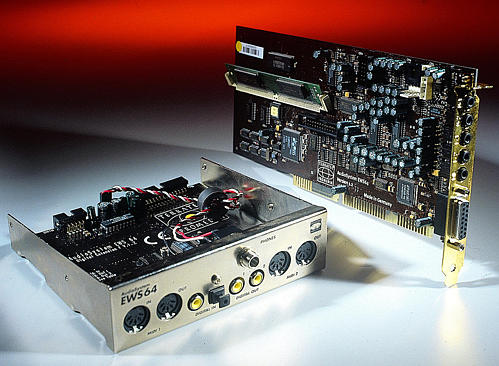

OK, let's go on about i865+Core2+DDR+AGP8X+ISA.
Now ISA.
I use a few basic standards for best sound in all games. There are Sound Blaster/Pro, SB16, GUS (GF1), EMU8k, Roland LA, Roland GM.
"Sound Blater/Pro"
Terratec EWS64 XL. S/PDIF IN and OUT! Resources: IO=220 IRQ=7 DMA=1 FM=388 MIDI1=300 MIDI2=320. On the MIDI1 channel I use Dream Synth with its own factory sound banks. On the MIDI2 channel I use MIDI daughterboard Roland GM. Here it is:
Roland GM
Roland SCB-55.
"Sound Blaster 16"
AV310 Audio Excel 3D. S/PDIF IN and OUT! Resources: WSS=dis FM=dis IO=240 IRQ=5 LowDMA=0 HighDMA=5 MPU=330. 100% SB16 standard compatible. On MPU channel Roland LA is connected. It is:
Roland LA
Roland MT-32. No comments.
GUS GF1
Gravis Ultrasound ACE. Resources: IO=250 IRQ=3 DMA=7 FM=dis.
AWE EMU8000
AWE64Gold. S/PDIF OUT! Resources: IO=260 IRQ=9 LowDMA=3 HighDMA=6 MPU=dis FM=dis AWE=640. This card plays through spdif only EMU8k sound. The digital Sound FX in most cases doesn't present on spdif out. Therefore I never use AWE64Gold as SB16. Only as EMU8000 AWE.
If I need Intelligent mode I load SoftMPU by using Sound Blaster IO260 IRQ2 MPU330.
All cards are plugged in 5-slot ISA riser.
Signal Lines Connection.
GUS Ace MT-32 64Gold
----------- ------- --spdif out
V V
analog in
--------------------spdif in
EWS64XL
--------------------spdif out
| s/pdif
V
--------spdif in
AV310
--------spdif out
| s/pdif
V
Digital Receiver DAC Amplifier.
This is my best DOS sound system.
