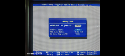

to my surprise , it supports edo. 32M double side. the fake cache nothing connected with ic chip, but shows 256kB here.

show extremely slow ram subsystem for 33MHz FSB 100MHz dx4. Those numbers are more in line with 486 SX-33 or even 25MHz 😮
486 dx4 100MHz should be seeing 45-55us/KB normal RAM read speed.
Can you override L1 cache mode to WT?
It looks like its in WB right now and this somehow makes ram slower making me question if the chipset supports 486 Burst bus mode at all. It also looks like it might think it does have L2 cache somehow? like its still trying to do L2 cache lookups despite no L2 cache installed - that would explain why ram slowed from 57 to 65 us/KB.
Also curiously first Megabyte doesnt appear to be L1 cached _at all_ 😮 Is there an option in BIOS for setting uncacheable regions?
Can you override L2 cache mode to WT?
Can you explicitly disable L2 cache leaving L1 enabled?

is it because I use dx4 100 nv8t? write through? another cpu is sv8b. the BIOS settings is default value, I changed disable next time.what is pity that we don't know the pin definition,otherwise we can wire the cache chips manually. OK,I will try.
