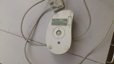

Ok, so maybe pojo is right. This mouse could be indeed one of these dual-mode mice. This would also make the most sense.
Maybe it was aimed at Amiga users, but because this platform was doomed, it was nolonger worth to produce special hardware for it.
Can't think of another reason they've named one switch postion "PC AT" (meaning PC and AT) and the other "MS AM" (MouSe AMiga).
If it was MS Mouse, "MS MA" would have been more appropriated. If it supports bus mouse, you could use a mouse driver that supports bus mouse
over serial connectiion instead of that ISA card (if one exits).
Or you could try to get PC/AT mode working. I bet it uses Mouse Systems mode or similar then and not MS Mouse.

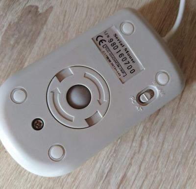

So I got the exact same mouse with the MS AM and PC AT switch (photo of OP's mouse in page 2)
212.83 KiB
2035 views
I also couldn't get it to work in DOS with any mouse driver in my collection, ctmouse, ms mouse etc. Moments before walking it to the bin I read this thread and thought... two of them? Not impossible but a bit unlikely, unless they had a specific bad quality/failing component.
So I tried all the drivers I could find and from what I tried the damn thing works only with the Logitech drivers , I got it to work with v7.3 http://www.vogonsdrivers.com/getfile.php?file … menustate=26,24 and in MS AM mode.
Of course it should work with other drivers as well. My point is that this thing is so picky, pickier than any other serial mouse I've seen, that it might easily pass for dead and end up in the trash. So if anyone else has the same before tossing it try the Logitech drivers 😉

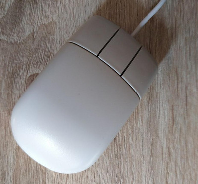

So I have one of these too. I found it recently, and it was the first time I'd seen one of these switches. I've just tested it on my 386.
82.31 KiB
1787 views
68.57 KiB
1787 views
In DOS, using the same CTMOUSE command that I use for my MS serial mouse, and Eric Rodda's MOUSETST.COM:
  • PC/AT mode: All working fine, including middle button.
  • MS/AM mode: Moving the mouse actives the button inputs. No cursor movement. And curiously, the Esc key to exit the test wouldn't work until I switched the mouse back to PC/AT.
In Win3.1:
  • PC/AT mode: No mouse function - not even a cursor.
  • MS/AM mode: Fully functional apart from the middle button, which I guess needs a driver.
Reply 55 of 65, by Jorpho
Pierre32 wrote on 2021-03-27, 23:06:
As per the documentation, you will likely have to invoke CTMOUSE with a different switch to get it to work in Mouse Systems mode.
http://home.mnet-online.de/willybilly/fdhelp- … ase/ctmouse.htm
Reply 56 of 65, by Pierre32
It was just a quick test TBH as this mouse isn't in active service. But since you mentioned it, it turns out using the options /Y /3 allows you to leave the switch in MS mode, and not have to worry about changing it between DOS and Windows. Good to know.
Some small differences between that page and my version of CTMOUSE, btw
