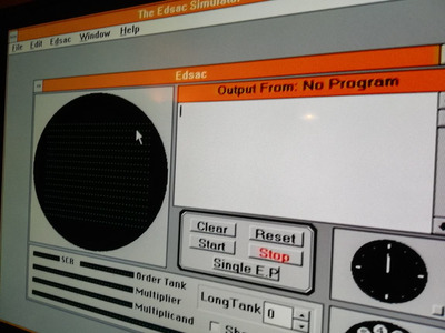

Hello everyone!
Today I like to present you EDSAC Simulator, a main frame emulator.
It seems to run just fine on Win 3.1+Win32s.
Tested successfully on real hardware.
Photo attached.
Edit: For those of you who may wonder what this all about..
The Electronic delay storage automatic calculator (EDSAC) was a British computer from ca. 1949.
That machine was the one which ran OXO aka Noughts and Crosses (Tic-tac-toe) in 1952!
Where a rotary dial served as a game controller.
https://en.wikipedia.org/wiki/EDSAC
https://en.wikipedia.org/wiki/OXO
Edit: There 's a video of OXO running on an EDSAC emulator.
https://youtu.be/iGe_brmoopc

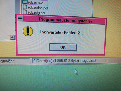

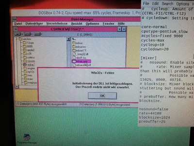

Quick update.
The Win32s error that occurs on DOSBox sometimes (DOS 21 error) likely can be fixed by changing cputype = to cputype=pentium_slow.
Reply 42 of 345, by xcomcmdr
I was about to say it, in fact.
I have a lot of experience about trying to run games inside Windows 3.11 inside DOSBox.
cputype=pentium_slow fixes a lot of bugs, when they happen.
core=normal can help sometimes too (but it's way more rare).
99% of games want 8 BPP, some want 24 BPP (but it's very rare).
DOSBox SVN sometimes fixes games that won't work with v0.74.
That's all on the the top of my head.
Oh, and sometimes the installation won't work in DOSBox, but you can install it in PCem (or real hardware), and then put the installation inside DOSBox and it runs.

Thanks a lot! I tried it and it improved compatibility a little bit. Most of the later Win32 emulators do still crash, though.
Originally, I even tried core=full , but it was not accepted for some reason.
Anyway, I'm going to check the Windows installation. Maybe other releases of Win32s work.

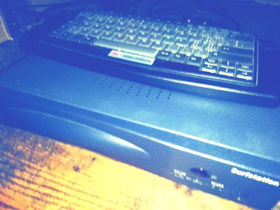

Problem with PCem/86Bo is, that I have no access to a "normal computer". All I do is done on a Raspberry Pi 4 with 4GB RAM and a Smartphone (+Camcorder).
Even my hobby videos are made with them. Not because I'm a big fan of that tech (-Pi is fine, though-), but because I couldn't decide where to go to after Windows 7 went EOL. 🙁
Technically, using PCem and DOSBox CVS would be possible, but I would need to compile that stuff on my own. Which is quite a work, from what I remember.
That's why I went the physical route and used my modded Surfstation JNT. It has a MediaGX (comp. to Pentium MMX), SCART output, SB16 clone and a CF card.
DOS 6.2x and Windows 3.10 (non WfW) run quite fine on it. Even added a NIC and patched the BIOS. And soldered in an SMD UART chip for serial support.
An additional micro switch allows for switching between PAL50 (720x576) and NTSC60 (640x480).. A patched SVGA driver (the one by Japeth ?) allows 256c.

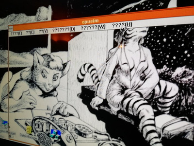

Quick Update.
Found another Japanese emulator..
It seems to be useful to assist programming/debugging.
"CPUSIM" seems to have graphical issues (overlay seems to fail) .
Maybe, in part, also because it was made for Japanese Windows (does it try to write in Kanji or load Japanese DLLs ?)..
Tested on real hardware.
Photo attached.

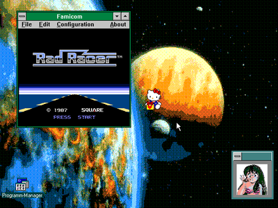

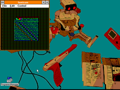

Good news!
I found another NES emulator called "Famicom".
It's a 16-Bit exectuable (Win16) and seems to work.
The fileformat(*.FAM) is obscure by todays standards, though. Gratefully, Cajones and Famconv can help.
Even if that means translating to Paso format first, in some cases. I wonder if everything also runs on a 286..
Screenshot attached.

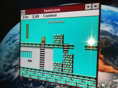

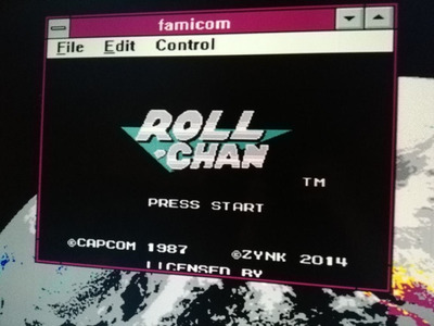

Edit: I did further testing with the early release of Famicom.
Seems the emulator als runs with Standard VGA driver in 16c (also tested 16m colours).
And it can play actual games, not just demos.

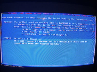

Edit: I did a few more tests and it seems converting to Famicom format is tricky,
as TetaNES confirms.
So it's really nice that v4 can import other formats, too.
Try experimenting what works best in each case.
Alternatively, you can try to use Cajones to convert to the Paso format first, which uses separate files for NES program code, character rom etc. Then use Famiconv to convert to Famicom's native format. Good luck! 😀

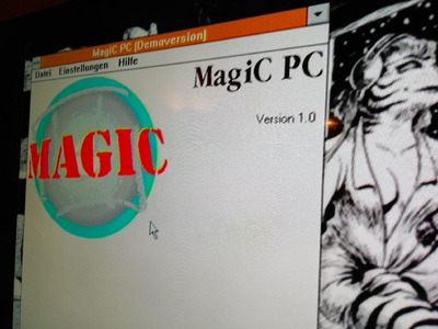

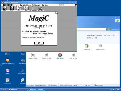

Update.
MagiC PC, an emulator of the TOS compatible OS of the same name (MagiC) , runs on Win32s.
Photo attached.
Edit: Just checked the program on a faster machine running XP.
MagiC runs rather well. Can emulate a floppy controller and some ports, but has a nag screen also.
It displays a "Have fun with our demo" pop-up window once in a while (but program is still up).

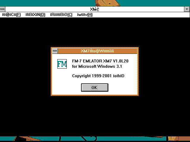

Here's another one - XM7, a multi-platform FM-7 emulator.
The package contains a Win16 binary, as well.
However, it requires files found in the Japanese Windows 3.1x (besides the FM7 firmware).
Namely, the files related to the Input Method Editor (IME).
You'll fine some of them at Otaku World (great site!):
https://otakuworld.com/index.html?/toys/utils.html
http://www.otakuworld.com/toys/howto/installsavers.html
More information:
http://www.nausicaa.net/~lgreenf/fm7page.htm
https://en.wikipedia.org/wiki/FM-7

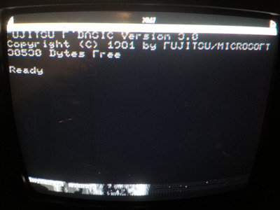

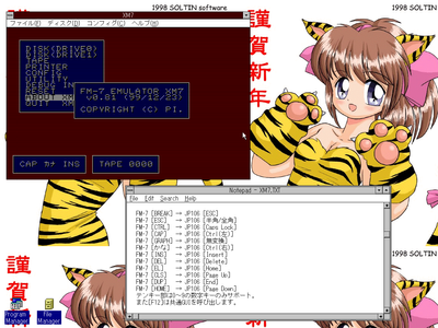

Edit: I made a little progress with this emu (v0.81). Seems F12 triggers an internal menu. Another key (°^ on my keyboard) functions as "confirm".
More information here -> https://retropie.org.uk/forum/topic/12538/xm7 … -not-working/14
http://retropc.net/ryu/xm7/xm7.shtml

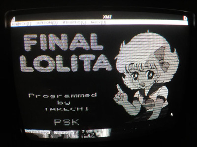

Edit: Ran XM7 on my Surfstation JNT and voila, BASIC came up. Very slowly.
The JNT has a MediaGX @180MHz and the readme file wasn't lying - a 200MHz MMX CPU is minimum.
Perhaps that's because the platform uses vector graphics in most games.
Or because it has to use old GDI for drawing on WfW (higher end ports use DirectDraw 3)..
Anyway, this emulator has modern requirements essentially. A 686 or higher CPU (Pentium II/III) should do.
New screenshot attached, also. Sorry for the sample game, it's not my taste.
Simply picked one random single floppy game since my Kanji isn't best. 😅
Game was chosen via F12 menu, not the Windows GUI..

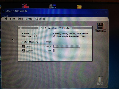

Heureka! 🙃
I found a way to boot up that old vMac build!
Turned out that System 5 is compatible!
See photo!
Next step: Windows 3.1x and Win32s.

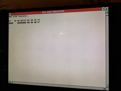

Hi everyone!
Here's another emulator : BBC 6502 Emulator.
Not sure what to do with it, but it runs fine on Windows 3.1x! ^_^
Photo attached.

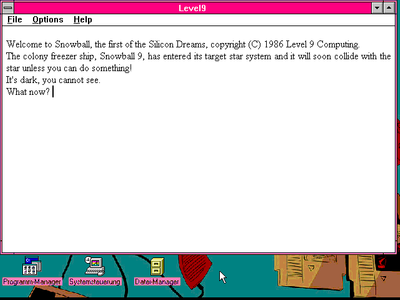

Quick Update.
Found Level 9, an interpreter for old interactive fiction (text adventures)..

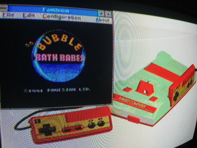

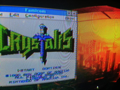

Hi again! Quick update!
Found a newer version of "Famicom"..
Among other improvemens (mapper support), it will also import common image formats.
From what I can tell, it still is a Win16 binary and runs on Windows 3.1x.
Edit: Tested a few more games.
Including the obligatory "Bubble Bath Babes", haha! 😂
Crystalis seems quite playable, haven't noticed any issues so far. Haven't expected this, it's kinda cool.
    35.19 KiB
    2080 views
    Famicom v4.04e (Win16)

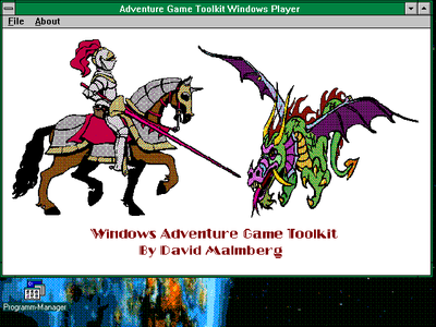

Good news!
I found another IF interpreter.. Windows AGT Player. From 1993!
See screenshot.

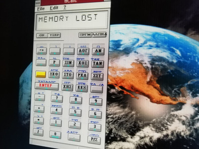

Hello everyone!
Found another calculator emulator that runs on Windows 3.1x.
It's ttcalc and it comes in English and German.

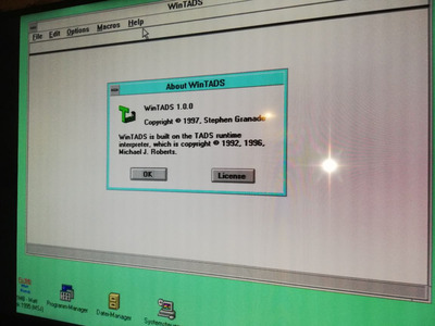

.. and another IF interpreter, WinTADS, running on Win32s (tested in Pentium 133).
Photo attached.
    85.08 KiB
    2034 views
    WinTADS v1

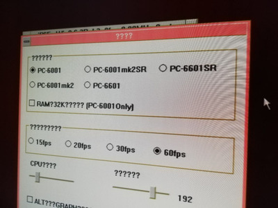

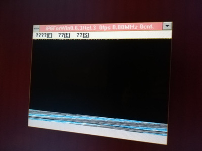

Hi! Another update.
Discovered an emulator for the NEC PC-6000 series, "IP6".
It seems to run just fine on Win32s, but asks for firmware/monitor files.
Tested on a Pentium 133.
More information: https://en.wikipedia.org/wiki/PC-6000_series
Photo attached.
Edit: Some more background information (source: intern. archive):
=== Overview ===
The PC-6001 was NEC's second line of personal computers after the PC-8001 series.
Nicknamed the "Papicom", the PC-6001 was a family-oriented computer at a budget price,
with bright orange keyboard buttons and a built-in cartridge slot for plug-and-play simplicity.
For a certain generation of Japanese geeks, the PC-6001 was their first computer growing up, and the nostalgia factor is high.
Even today, there is still a community of Papicom fans making homebrew software for their beloved machine.
Models:
- PC-6001 (1981). 4-color graphics and 3-voice PSG. Extra RAM, extended BASIC, voice synthesis, and external floppy disk drive available as add-ons.
- PC-6001mkII (1983). More RAM, better graphics (up to 15 colors), and built-in voice synthesis.
- PC-6601 (1983) - Basically identical to the PC-6001mkII, but with singing voice synth and a 3.5" floppy disk drive. Bundled with the game Colony Odyssey Bouken-hen.
- PC-6001mkIISR (1984). "SR" stands for "Super Revision". Added higher resolution support and 3-voice FM synthesis.
- PC-6601SR (1984) - Nicknamed "Mr. PC". Released roughly at the same time with the PC-6001mkIISR.
Basically a PC-6601 plus 3-voice FM synth and TV superimpose functions. Also a completely shameless ripoff of the Sharp X1 in design and looks.
    49.14 KiB
    2005 views
    IP6 for Win v0.6.3r3
    100.16 KiB
    2005 views
    IP6 settings menu

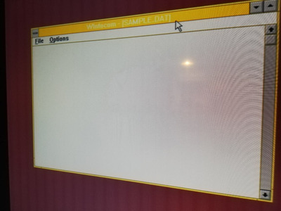

Update.
The Z-Machine emulator, Winfocom, runs on Windows 3.1x.
It's a 1994 release and seems not to require Win32s.
Unfortunately, I had no matching game files at hand, haha. 😅
Photo attached.
    75.98 KiB
    2005 views
    Winfocom v1. 0 beta
