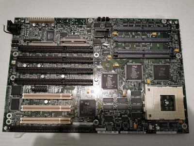

Reply 44 of 59, by lukas12p
Do You recognize what version is that?
PBA 619773-008
Would manual http://ohwc.narod.ru/man-dat/mainboards/intel … ans_revenge.pdf work with it?
Reply 45 of 59, by The Serpent Rider
Yes, these boards have only minor differences between revisions and jumpers are identical anyway.
Reply 46 of 59, by feipoa
lukas12p, if that is a socket 4 on it, then you have the rarer version of this board, the one with the 5.27 V VRM for running the P66.
Reply 47 of 59, by The Serpent Rider
That's early revision Socket 4 board. You can easily spot Socket 4 by two unsoldered squares below L2 cache chips.
Reply 48 of 59, by TheMobRules
Recently got one of these boards, but unlike the one posted by lukas12p it doesn't have the voltage regulator, coil and capacitors near the power connector, the component locations are there but unpopulated. It has a jumper near the top memory slot for selecting 60 or 66 though.
Does anyone know if I will be able to run a P66 stable without the VRM? So far I only have the P60 that came with it, but I'd like to try a 66 at some point.
Reply 50 of 59, by feipoa
Yeah, P66 works on mine too without the 5.27 V VRM. Kind of makes you wonder which tests Intel was doing which were failing at only 5.0 V on the P66 that needed the extra 0.27 V to pass.

You need an early Pentium 66 for such regulator. Later steppings improved yields and VRM requirement became obsolete. But let's also not forget that 5v rail from PSU could be lower or higher than 5v. So it's entirely possible that your PSU can compensate lack of VRM, especially if it's a modern PSU.

Reply 55 of 59, by lukas12p
Hi
I try to make any usage of my "new" motherboard. It works with P60@66, but I can't make COM port work with my mouse (it work with other computers). I tried two motherboard connectors, mouse gets power (I have led installed in it), but it doesn't work in DOS or Win95. COM ports are active in BIOS and recognized in Win95.
Question is:
1. Is there non-standard COM pin-out on this motherboard?
2. Where is PS/2 connector?
Reply 56 of 59, by feipoa
If your board doesn't have mini DIN's, the PS/2 connector's solder pads are sitting next to the AT keyboard. Either you can desolder the AT keyboard connector and solder on two mini DIN's (one for the keyboard and one for the ps/2 mouse), or you can solder in some wires to the solder pads and connect it to your own PS/2 header that will be loose. I think I glued or found a way to fudge a ps/2 header onto this board so as not to have the dangling header/wires.
