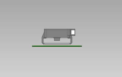

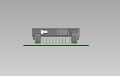

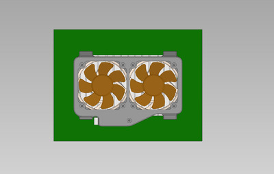

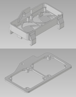

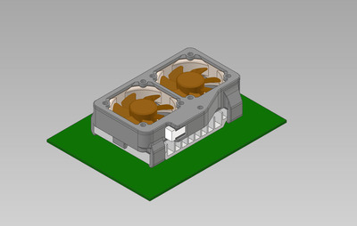

Reply 45 of 62, by a_h_adl
This was my take on for cooling my Voodoo3's about 3 years ago but never ended up 3D printing it as my printer has been broken since. it uses two Noctua NF-A4x10 and two 3D printed parts screwed together and the whole assembly just snapped on the stock heatsink with tabs without any modifications to the card and heatsink:

That is amazing! Any chance of making this available for others to print?

I realize it's been a hot minute, but figured it's worth asking again... any chance you'd share these designs for us to 3d print?
Reply 48 of 62, by a_h_adl
mitchkramez wrote on 2024-02-06, 03:51:
Sure, I have attached the model below as Zip file. It contains the STL files for upper and lower pieces. I also attached the STP file if you need to measure anything or to recreate it by yourself.
Just bear in mind, I never had a chance to print and test it by myself so it might need some tweaking and changing some dims to make the gaps tighter or looser or strengthen some areas after the first print, based on the printer type and how flexible/fragile the used material is.

Wow - this is great - thank you for sharing the original files as well! Do you have any issues if I share any modifications I need to make back here? Again, greatly appreciate the time you put into this, it's a lovely model 😀

First pint attempt came out nice. The clips on the lower edge bump up against the adjacent PCI slot unfortunately. I’m thinking of moving those clips around to the side, and just place a small lip on the lower edge against the slot there. this will have the added benefit of being able to just slide the whole cooler on and off from top to bottom. My fans should arrive this weekend and I can confirm fitment for those then.
As is, the card did insert far enough into the slot that it did work, but doesn’t seat fully with the clips against that PCI slot. Overall the clips were a bit too tight as well, but I think if we move the bottom ones around to the sides we’ll likely not have to worry about that.
I’ll hopefully have some time this weekend to adjust the originals and do some more test fits 😀

Awesome - Thanks for all the details! I think we've got a fully functional model now!
- Card seats fully now and clears the adjacent PCI slot
- New clip layout allows for you to slide the whole thing on from the top and the flexible clip on the bottom locks it in place nicely.
a_h_adl - i'd love to post this to printables.com to share with people if you don't mind - 1. are you ok with that if i attribute your work (since you clearly did the most of it) and 2. do you have a user account that i can mention in the description?
as always - thanks again, i'll post the STL files for people here if you're ok with that as well 😀

Reply 56 of 62, by mitchkramez
a_h_adl wrote on 2024-02-11, 23:14:
That is a good news! happy to see you finally made it happen. I almost forgot about this and you finished it up so consider it y […]
mitchkramez wrote on 2024-02-10, 21:58:
Awesome - Thanks for all the details! I think we've got a fully functional model now! - Card seats fully now and clears the adj […]
That is a good news! happy to see you finally made it happen. I almost forgot about this and you finished it up so consider it yours. feel free to post, or use it anyhow you like, and don't bother mentioning me, you made it happen!
I'm pretty sure you've already figured it out by yourself but it doesn't hurt mentioning my plan for two fans were to cut one of the end terminals and solder it to the wires of the second one in parallel and place the only actual Noctua terminal where the small white part is located in the model. it should be sitting perfectly as per my old measurements. Can't remember if it needs a drop of superglue or not, but this setup makes the whole fan system nice and tidy without wires hanging down from the card.
Can't wait to see the photos of the actual finished voodoo 😀
I’m definitely going to mention this thread and you for everyone, there was clearly a lot care put into your original design and I’m glad that I could help out with it!
I did figure that’s what your plan was with the cable channel there, but for my purposes i’m just using a splitter to combine them into one - the noctua cables are so nice anyway 😀
I’m only awaiting the screws to arrive to assemble the rest of it in my platinum beige filament, but may print another set in black petg 😀
I plant to post these tomorrow for everyone - Thanks again!
