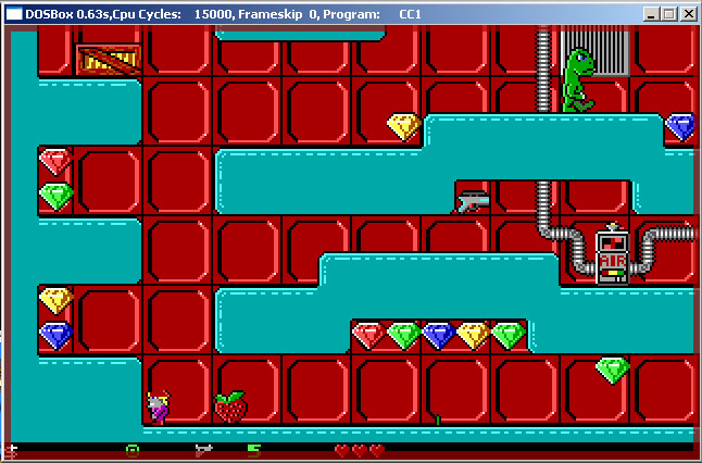

That's why I was thinking of blending the border color with color of the underlying game pixels. It wouldn't look very pretty, but it would scale well. You could even get fancy and make it appear as a colored haze effect around the edges of the picture.
Another idea: is there a way you could make the thickness of the border dependent on the size of a game pixel? In other words, could you code it to draw the border as 50% or 25% (or whatever) of the thickness of a game pixel, rounded up (so that it's still visible in low resolutions)?

But we've been discussing ways of dealing with this: either blending the border color with the game color, or drawing a color border around the edges that is thinner than the game pixels around the edges (which is of course can only be done without obscuring entire pixels if the game pixels are being scaled to bigger than one real pixel)
Reply 46 of 67, by vasyl
Well, single pixel does not work well -- not very readable. Interlined pixels was just too odd. OTOH, blending was not nearly as bad as I expected. See the example. Three pixels are used for border. Blend ratio of border to game color is 2:1 to make border more pronounced. Right now I have only normal scaler working this way and it is still 50% a hack but it can be done properly with not too much effort. It has to be switchable from dosbox.conf as well. The performance overhead is there but it's not very bad.

Reply 48 of 67, by vasyl
Sorry, my mistake. I've noticed this +1 bug in code after I submitted the message. You have very sharp eye.

it looks very cool, unfortunately it makes the HUD look very weird. it almost defeats the purpose of making the HUD stop shaking.

also, I'm worried about how this border will affect gameplay, like getting the reflex of "ENEMY COMING" 3 pixels later because my brains will automatically ignore what's behind the red border?

It is blended so it does not obscure any pixels completely. The technique should work in all games, the implementation is not specific to Crystal Caves, although I haven't tried to modify scalers other than normal2x yet. It has to be configurable -- in some games three pixels is the best settings, some may require more or less. The blend ratio needs to be configurable as well. I have 2:1 in my example but some games may require much weaker effect. Incidentally, what other games actually used border color as part of gameplay?
