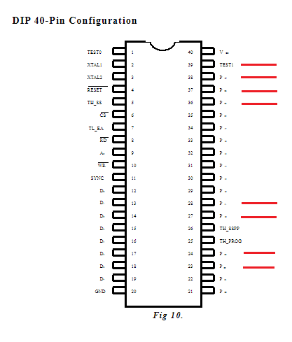

I checked which pins are not connected and noted them:
10.59 KiB
1208 views
They all show some continuity to the PS/2 header. Is it safe to jumper them straight through the pins around the socket with them already connected in circuit?

My design already passes through all the GPIO pins except for P10, 11, 22, and 23 because those are required for the mouse.
IOW what you're asking for is impossible.
Reply 413 of 543, by maxtherabbit
mockingbird wrote on 2023-08-16, 19:16:
Every single one of those is required for the proper operation of the mouse. If you start messing with them bad things will happen

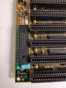

Reply 418 of 543, by mockingbird
maxtherabbit wrote on 2023-08-17, 22:09:
I'll be happy to talk you through the resistor thing but first could you please post a photo of the motherboard in the area around the keyboard controller?
Thanks, that's very gracious of you.
557.05 KiB
1108 views

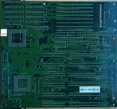

And this photo is from The Retro Web:
1.65 MiB
1108 views

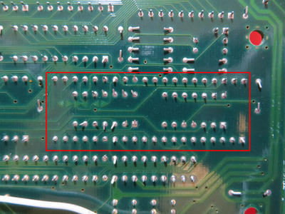

EDIT:
Here is a photo of the top from The Retro Web (sorry about that, I'm a bit slow today):
1.43 MiB
1089 views

Reply 419 of 543, by maxtherabbit
Thank you, it appears pin 24 controls turbo on your board. In your first photo you can see the tiny trace jumpers (the little triangles) that select between pins 23, 24 and 27 with the one for pin 24 connected.
Unfortunately for you, all of those pins are required for the mouse so it's not as simple a matter as changing the jumper. What I would recommend is taking the mod board out and putting the original KBC back in the board. Then, with the system running at full speed, measure the logic level of pin 24. You can also use the keyboard shortcut to de-turbo the machine and verify that pin changed state as a sanity check.
Once you know whether we need to pull pin 24 high or low we can select an appropriate resistor value.
