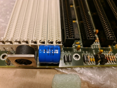

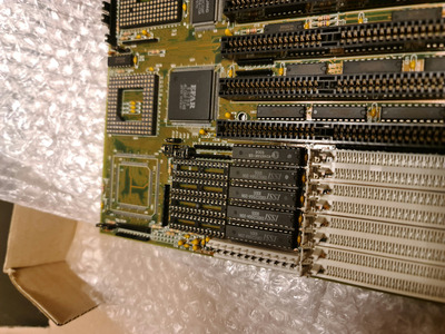

Reply 4140 of 5230, by weedeewee
Luke4838P wrote on 2023-03-29, 20:32:
Found this 386 motherboard. Really tiny and compact, 5 ISA slots with 486 ( 168 pin PGA) support. Unidentified so can someone h […]
Unidentified so can someone help me recognize it?
CPU is a soldered AM 386DX-40.
Looks a lot like this one https://theretroweb.com/motherboards/s/inform … -it-am33-40-dlc
I doubt it's a 486 socket. More likely a 387 or weitek coprocessor socket
Do not ask Why !
Reply 4141 of 5230, by Luke4838P
weedeewee wrote on 2023-03-29, 20:56:
Yeah, sounds like that one.
The socket though is too large for a 3167 or 387.
It's a 145 pin with a strange shape.
Anyway, what kind of damage did this MB took?
It looks more than the leaked battery due of those strange oil-like stains.
Can i run it safely with the external BT connector?
Edit: too little pins to be a Pentium OverDrive.
Reply 4142 of 5230, by weedeewee
Luke4838P wrote on 2023-03-30, 09:47:
Yeah, sounds like that one. The socket though is too large for a 3167 or 387. It's a 145 pin with a strange shape. Anyway, what […]
It just has an extra inner square of pins. both weitek or normal copro would fit.
why those inner pins are there... maybe a manual could tell us.
Do not ask Why !

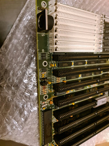

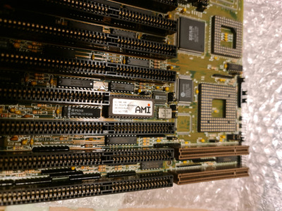

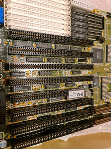

Reply 4152 of 5230, by Luke4838P
pentiumspeed wrote on 2023-04-02, 22:50:
This is for CHIPS super 386, J386xxx. Very rare CPU and looks like a 486 package in a 144 pins. […]
weedeewee wrote on 2023-03-30, 10:11:
https://www.cpu-world.com/forum/viewtopic.php?t=37551
Cheers,
Uhm, so it means almost certainly is not going to be found easily, i take.
Anyway, another mb arrived this week.
A 386-486 hybrid motherboard, that despite the barrel battery, it miraculously has no damage or leakage.
The mainboard is perfect and the battery as written above, has a very minor leak (some blueish oxide at the negative pole of the battery) so the motherboard is in excellent condition.
The battery had a 0.09V voltage left when I measured it with the multimeter so I take that it is dead, amazingly though it didn't leak.
The motherboard has sockets for 386 and 486, VESA and what it seems a ps2 mouse connector just next to the keyboard connector.
Is the "486" socket an hybrid to house both 387 and 486s?
Can someone help me confirm this?

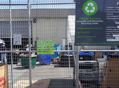

Reply 4153 of 5230, by Repo Man11
I stopped by my local E waste facility to drop off some junk, and I had to laugh at this sign. They really don't want you to take anything away. Note the very tall fence they have to prevent anyone from "Rescuing" any old computers or parts.
A lot of times when you first start out on a project you think, This is never going to be finished. But then it is, and you think, Wow, it wasn't even worth it. - Jack Handey

Reply 4156 of 5230, by Kahenraz
Repo Man11 wrote on 2023-04-07, 21:32:
That's a terrible policy considering that the "reuse" is the most important part of recycling. They probably have a hoader on staff that is picking through the e-waste for valuable stuff and trying to block anyone else from getting it. You can tell by the handwritten sign that it's probably that.
Unless it's considered theft, I would personally just ignore the sign unless someone came out and told me not to do it in person.
Reply 4157 of 5230, by Repo Man11
Kahenraz wrote on 2023-04-07, 22:33:
They definitely consider it to be theft. As I've mentioned before, their old facility was too small, and stuff would overflow out to the front where it was completely unsecured. I would stop by when they were closed and scrounge, but one evening I stopped by just a little too early and they were still open. No one was out front so I began looking through the pile of stuff, and a guy came out and told me "You can't take anything from here", so I left and came back a little later.
