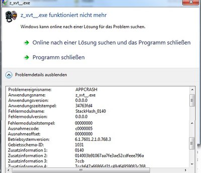

Reply 433 of 3949, by teleguy
X-Wing vs Tie Fighter (GoG release) almost works except that the game crashes a few seconds after entering flight mode both in software and hardware mode.
