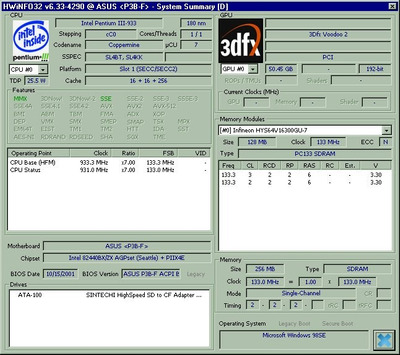

vutt wrote on 2020-10-19, 11:43:
Do you really need my full software library listing? You are I suppose interested only about [HKEY_LOCAL_MACHINE\Software\3dfx […]
Mumak wrote on 2020-10-19, 10:06:

Thanks for the dump. Indeed, I was interested in the "3dfx Interactive" node only, but since HWiNFO didn't report any of those values I thought it's not present with this driver set.
Now I can see that memory information is missing there, hence why HWiNFO doesn't report it. But at least the GPU clock should be reported, isn't it?
I have spent a lot of time trying to implement direct readout of those parameters from the chip, but it didn't work. The registers just didn't behave the way they were described in specifications. Also some parameters could not be retrieved on a system which is actively running (driver with active tasks) as it could cause issues. So all that I ended up was to read those registry parameters. I always strive to read information from HW directly, but that wasn't possible in this case 🙁

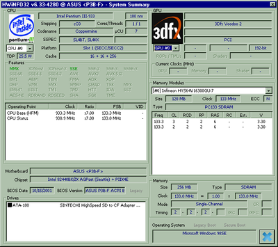

It seems complicated indeed, because even contemporary devs when this hardware was more relevant weren't able to determine memory sizes. Both early 2000's Everest and 3DMark 2001SE are not able to determine memory sizes 4 + 8 MB in my case. However both of them are showing clock value.
For reference how it looks like for me in HWInfo atm.

Thanks. Looks like there is be a bug in the current HWiNFO versions preventing it from showing some data (i.e. clocks) on Voodoo2. Let me try to fix that in the next build 😉

Could you please try version 6.33-4285 Beta if it fixes that issue?

Mumak wrote on 2020-10-25, 09:23:
vutt wrote on 2020-10-19, 16:22:
Mumak still thank you for your effort anyway.
I run latest beta 4290. It looks like it isn't working - Voodoo 2 with 50GB VRAM 😀, still no GPU clock...

Reply 432 of 683, by Mumak
vutt wrote on 2020-11-01, 19:45:
Thanks. Found another bug, sorry about that. Shall be fixed in the next build.
Reply 433 of 683, by vutt
Mumak wrote on 2020-11-01, 22:04:
Tested Voodoo 2 with 635_4305. Voodoo 2 GPU clock is now showing up correctly - 93MHz

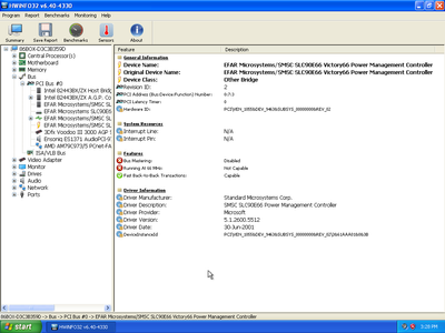

HWiNFO (and just about any other tool) doesn't read SPD data from the SMSC SLC90E66, a rare southbridge that mostly mimics the PIIX4 (apparently with Intel's blessing). It has the same function layout as the PIIX4, and according to the datasheet (p. 149-154) and the Linux kernel (l. 785), the same SMBus controller located in the power management function, which has a PCI ID of 1055:9463.

RichardG867 wrote on 2020-12-11, 20:09:
Thanks for the feedback and info! This one should be easy, please try this build and let me know if it works: www.hwinfo.com/beta/hwi32_641_4331.zip
Reply 439 of 683, by RichardG867
Mumak wrote on 2020-12-11, 20:53:
Works perfectly, I get all the SPD data now. Thanks.
