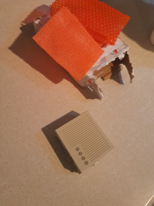

My package arrived slightly damaged, but it looks like my tinyllama2 is unharmed.
1.14 MiB
1675 views
PSU wise, would a 5V 2A PSU be enough? or should I get something else?
also, which button is which on the tinyllama2?

About 2A Psu, for my tiny llama, was not enough. In the end, I used 20W PSU. PW is the first button from the left, the second it’s reset, and two others are mt32 buttons.
I measured the current draw a while back, don't remember the exact numbers but it was in the ballpark of slightly under 1A. There might be an initial surge though, and of course whatever you plug into the various connectors (USB, SD) will draw power as well. So yeah, the boring answer is as always: it depends. 😉 Never hurts to overshoot when it comes to power supplies.

@sndlbn
Thanks for the info on the PSU and buttons.
I'll start looking for a beefier PSU. maybe one of my phone chargers will have enough.
I'm assuming it needs to be 5V? or can it take 12V too?

Only 5V!! 😁

Often the problem isn't the current rating it's the voltage sag. USB cables are often the cause of this - I did a test on a lot of cables a while back and they all performed very differently. Some brand-name ones would drop down to 4v at 500mA...
Also a lot of "5v 2A" power supplies will drop down to 4.5v or lower if you get them anywhere near their rated current.
The raspberry pi power supplies actually run at 5.1v to help overcome these issues, that would probably be a good choice for the tinyllama

Yeah, good points! I think Apple's chargers do that as well. A newer iPad charger has USB-C output and would probably work well.
