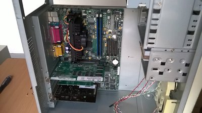

https://drive.google.com/file/d/0Bzzash5ZKLeK … iew?usp=sharing
Here is a picture I took back then, of the machine without any cables mounted.

Looks like my motherboard does have it. There is a 6 pin header (one pin missing) in the bottom right of the board labeled PC/PCI.
