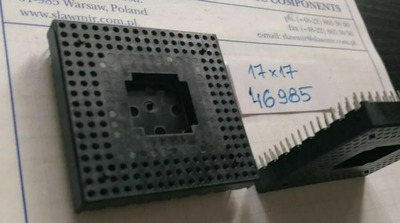

Reply 456 of 543, by feipoa
Three options turn up on eBay for "PGA 168", but they are all LIF.
For ZIF's, I normally pull the top cover and replace the damaged pins from donor boards. I wouldn't mind knowing a source for cheap 486 ZIF's.
Reply 457 of 543, by maxtherabbit
feipoa wrote on 2023-10-31, 01:27:
Thanks. That Polish seller has this type, which is far and away my favourite type of LIF socket
116.89 KiB
1006 views
Reply 459 of 543, by maxtherabbit
feipoa wrote on 2023-10-31, 02:41:
It is hard to distinguish from the photo if the female contacts are gold plated or tin.
Good catch, they're not. Guess I'll have to go with that segpart guy in USA who has the same style of socket with gold contacts.
