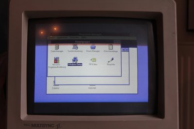

Hehe, already finalized the TSR for my PEGA. Had to intercept 2 calls:
00: Set Video mode 12-->50
0F: Read Video mode --> report 12
Now Windows is running with 640x480. Some drawing errors but I do not see a false color.
More later...

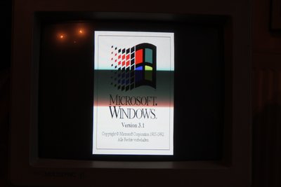

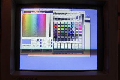

And Windows Display and Palette:
With VGA Driver:
Start Logo with wrong colors
The attachment IMG_1174r.jpg is no longer available
Palette looks OK, but some Display problems...maybe related to my TSR which return the wrong screen number. Cannot remember this was the case with my Chips card, but the colors looked similar.
The attachment IMG_1172r.jpg is no longer available

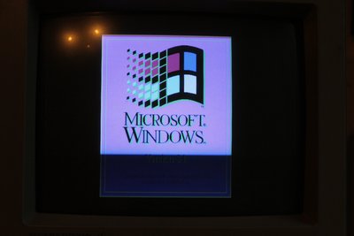

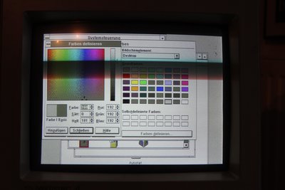

Then I switches to the standard EGA driver for comparision:
The attachment IMG_1175r.jpg is no longer available
The attachment IMG_1177r.jpg is no longer available
Some color differences, but palette looks similar.
And when installing a VGA card it will also look similar.
Proven that:
VGA 640x480x16 mode works on EGA cards supporting the 640x480 mode 😉
Thnaks for listening, was fun 😉
