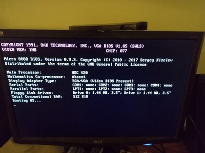

Reply 510 of 615, by keenerb
Got mine assembled, and it boots.. Only one memory chip, so only 512k, but it seems to be booting OK.
I need to tear down one of my othe rmachines to get my floppy controller and CF ide adapter installed, but this looks pretty good to me.

I've flashed 0.9.4 bios, and I am spammed with IOCHK NMI dected. Type 'i' to ignore IOCHK NMIs, or 'r' to reboot.
Hitting "i" just repeats the prompt.

Have you tried ROM 0.9.4 from Sergey? The NMI error seems spurious to me, I don't think it's valid.
