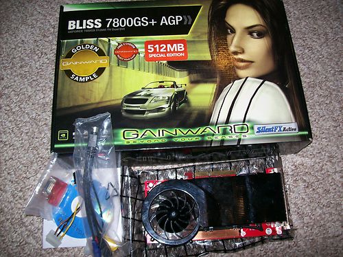

In 2008 I went from an insanely expensive (because they didn't have them in the US) Gainward Bliss 7800GS+ (7900GT Core) AGP card to a much cheaper (and smaller) HD3850 for my Nforce3/Socket 939 4400+ setup and was blown away by the performance too.

Artex wrote:
In 2008 I went from an insanely expensive (because they didn't have them in the US) Gainward Bliss 7800GS+ (7900GT Core) AGP car […]
I have that HD3850 AGP card to. But i dont like that cooler at all.. Its very noisy.
