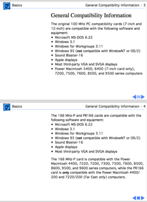

Reply 60 of 94, by NJRoadfan
The 12" DOS card should work in any PCI PowerMac. I don't recall anything "special" about it. The entire line of "DOS Compatible" Macs were just machines that came with the card pre-installed from the factory and a case badge.
Reply 61 of 94, by dr.zeissler
Did not knew that, thx! I always look at the description from apple.
    263.06 KiB
    1749 views
Reply 62 of 94, by derSammler
"Far East only" indicates that there was some legal issue back then, which is probably the reason for that statement. Or maybe the PR166 card got no FCC/TÜV approval for the rest of the world. 😉
Reply 64 of 94, by derSammler
No idea. The 7300, 7500, and 7600 share the same mainboard, so there should be no difference. Case is the same, too. Maybe the 7300 was sold with a too weak PSU. The P100 card certainly draws more power than the newer P133 one.
