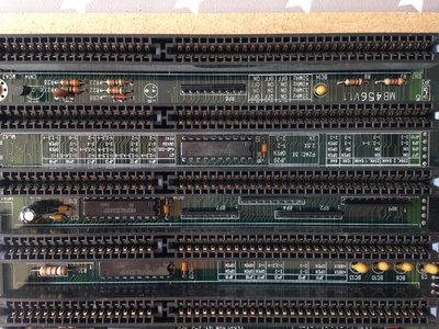

Gerwin, you are a life saver! Last week I scored an 486 system on Ebay. The motherboard simply stated MB456V1.1 which gave no google results. Then I searched the UMC chip set and hit the jackpot with this post. Your package for TK8498F motherboard and VGA+Multi-I/O gave me all the info I was looking for. It seems this UCM motherboard design is available with a variety of different markings on the board. As already mentioned in this post, my 486 UCM rig also includes the UM85C418 VGA/Multi-IO VLB board. Thanks a million for your detailed posts, it has become my 486-bible.

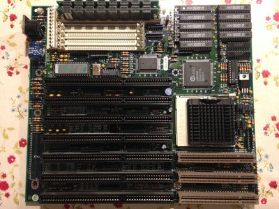

The 486 was extremely dusty. I did not take any pictures when it came in. I bought it because I needed the VLB video card, controller card and audio for another board. After I found this post, I played with the MB for a while, trying out some combinations of RAM, CPU and cards. In the end I put it aside due to its multiplier limitation. It came originally with an Intel 486DX2-66 S (heatsink glued to the CPU) but in the end I used an AMD 80486DX2-80. If found one lying around but, it too, had the heatsink glued. Since AMD does not mark the bottom for these CPU's I pried loose the heatsink but it took some of the top surface with it. With the help of cpu-collection.de I figured it was an AMD A80486DX2-80NV8T.
Here is the motherboard with the original 486DX-2 66-S. I had already removed the 2x8Mb EDO and replaced it with double sided 2x32Mb EDO. Cache shows all banks 32Kx8 20Ns for a total of 256Kb.
2.77 MiB

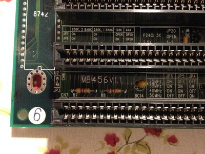

Board marking
1.36 MiB
3321 views

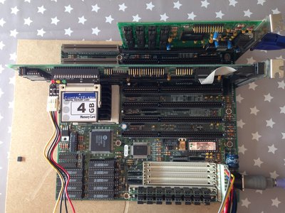

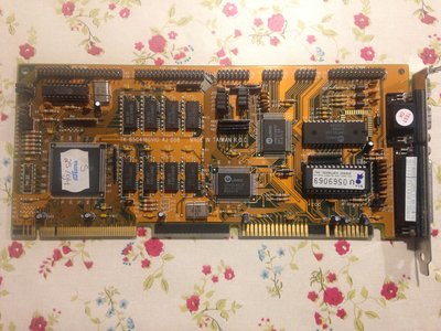

TK85C418GVIO-4J-D08 for which I found the jumper settings in your documentation! I disabled the HDD/FDC as it was not stable and used a seperate VLB I/O card.
This card ended up on the other 486 board (ZIDA 4DVS, AMD486DX4-100)
2.89 MiB
3321 views

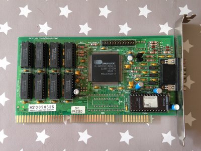

The Cirrus Logic GD5422 I used for the benchmarking

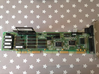

The I/O board used for the benchmarks. It's an UMC card with UM82C863F/UM82C865F and branded MIO-VL P103.

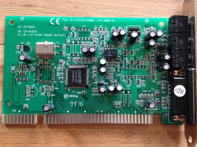

The Crystal CX4235-XQ3 that also ended up on the new board. I was unable to get it working in pure DOS. No issues with WIN95.
2.79 MiB
3320 views

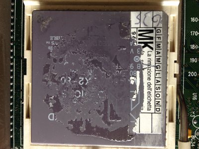

The AM486DX2-80 after I removed the heatsink. It's the AMD A80486DX2-80NV8T as it has the 'N' is barely visible under X. In addition it shows the 'B' under A80, which is part of the B 9520 APD T marking.

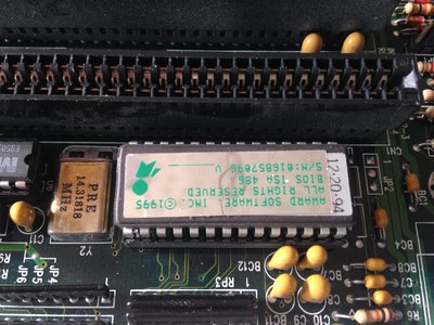

AWARD BIOS

Excellent jumper markings on the board

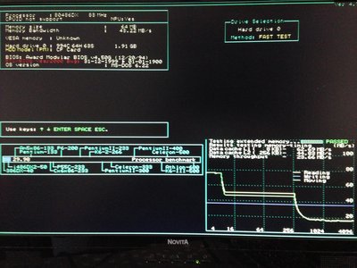

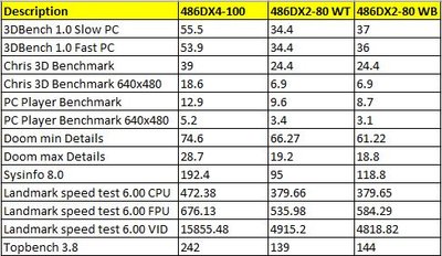

VOGONS has an awesome collection of benchmark programs. A big Thank You to Phil and others for initiating and uploading these. As I am rather lazy than tired, I simply use Phil's DOSBENCH which I downloaded from his site.
Results:
55.44 KiB
3315 views
1.47 MiB
3315 views

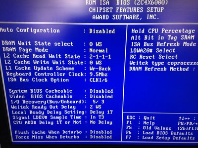

Although the battery clearly needs replacement, it doesn't leak and after a couple of hours of operation seems to gather enough energy to retain changes in the BIOS for a couple of days. So, if I use the board regulary, there is no need to setup the BIOS each time I start the machine. It's a fun board and I am happy to have it in my collection.

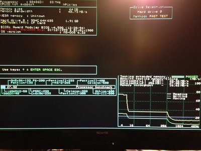

Forgot: as can be seen above, I was playing with Write Back and Write Through. Speedsys 4.78 above shows the WT results. With WB the outcome for Speedsys is slightly higher. In the Excel overview different outcomes show and not all results are higher for WB.
Speedsys for WB
1.65 MiB
3313 views

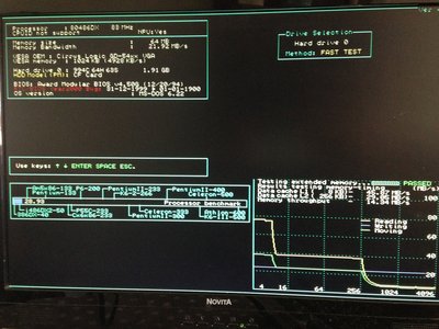

After tweaking the BIOS a bit more, all WB totals got even better.
2.1 MiB
3313 views
Speedsys for WB after BIOS tweak.
1.51 MiB
3313 views

-Did you use the original BIOS?, would it be possible to make a BIN file of the BIOS?
Reply 68 of 75, by gerwin
I used the settings from Total Hardware '99 for the identical board F4DXL-UC4. All is in the package I uploaded to vogonsdrivers before.
CPU Type     JP11         JP12         JP13     JP17     JP18     JP19     JP20
AM486DX4 2-3 2-3 1-2,3-4 1-2,3-4 1-2 Open Open
Note that the above does not match the silkscreened settings for P24C, which is the DX4 codename.
