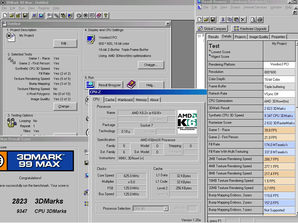

Reply 61 of 107, by Skyscraper
I diddnt manage to finish all the game testing today as Im rerunning all tests with some new BIOS settings that is 0.1 - 0.3 FPS faster for the speed settings that run with the onboard cache disabled. I will wait with posting most of the results another day or two 😜
Here are two more scores that Im pretty happy with for now.
New personal SuperPi record again with this CPU and motherboard.
SuperPi 1M @ 5x125MHz with the onboard cache deactivated.
This is my best 3dmark99 CPU score with the K6-3+ so far, the 3dmark score is nothing special.
3dmark99 @ 5x125MHz with the onboard cache deactivated, Voodoo III 2000 PCI @183/183
Reply 62 of 107, by meljor
Very nice, iirc my k6-3+ 600mhz was around 8000 cpu marks so that is a nice jump!
But you said it: 3dmarks nothing special. How is that possible? on a k6-2 450 (p5a, 128mb) i scored 2293 3dmarks with a v3 pci 2000 at stock settings and 1024x768.
V3 is still bottlenecked but i expected a bigger jump anyway with a 175mhz higher clocked cpu with cache and an overclocked v3 at lower resolution.
3dmark99 hangs a lot on 3dnow! maybe try running sandra or everest (or both).
btw, p2-450 and stock v3 2000 pci 1024x768 scored 3252 3dmarks so get up there, start using ice! 🤣 (p3-450 scores even higher with sse)
Reply 63 of 107, by Skyscraper
meljor wrote:
Very nice, iirc my k6-3+ 600mhz was around 8000 cpu marks so that is a nice jump! […]
I think the rather bad 3dmark score is because of the combination of the Gigabyte GA-5AX and the PCI Voodoo III.
Phil wrote that in his testing the Gigabyte GA-5AX with a Voodoo III was slower than all other Socket-7 boards he tried. It seems the board is good for CPU benchmarks but sucks when it comes to 3D, especially with a Voodoo III. In DOS for some reason he got more competetive scores so the performance issue seems limited to Windows.
The driver Im using is perhaps not the fastest either but its the same driver I used with my Intel reference system. I get pretty bad 3d scores in all benchmarks and games with the combination of the PCI Voodoo III and the Gigabyte GA-5AX.
Another thing that perhaps isnt optimal is that Im using Direct X 8.1a, again this was what I used with my Intel reference system which wasnt exactly fast but at least more in line with my expectations.
I have benched Sandra 99, PCMark 2002 and CPUmark 99 and the scores I got were great so the CPU performance isnt the issue, neither is the memory bandwidth.
Edit
Well its not the driver, I tested one of the last WHQL drivers for the Voodoo III and it was much slower than "Amigamerlins" driver pack.
I think Im going to give up trying to get the Gigabyte GA-5AX to perform good with the Voodoo III PCI and try one o my M577 PC-chips boards instead. I will still post the results I got with the Gigabyte GA-5AX though, just not tonight. The boring thing with the M577 is that it dosnt support any FSB over 100 MHz.

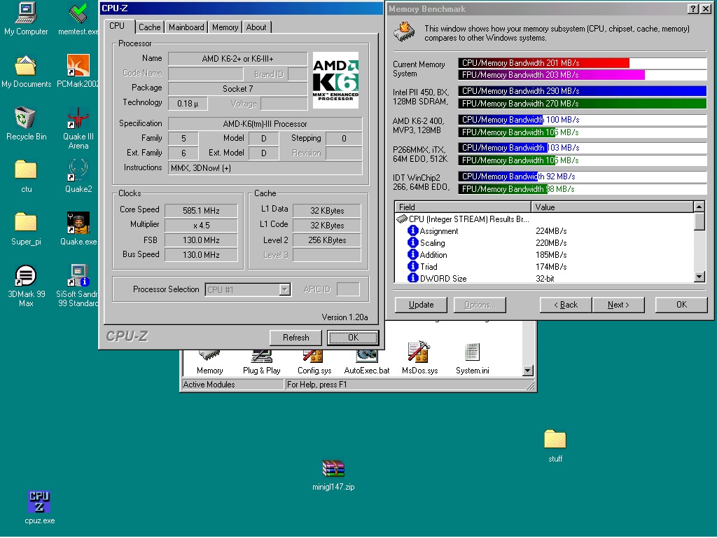

Reply 64 of 107, by Skyscraper
I managed to shave off another couple of seconds and set a new best SuperPi 1M time again.
K6-3+ @ 4.5x135 Mhz, Gigabyte GA-5AX, 256 MB PC133 CL3 @ 135 CL2.
Still no luck with running SuperPi @ 4.5x140 as the memory module the board likes best isnt really capable of 140 MHz CL2, at least not in my hot apartment. It can wait until the cold season.
I diddnt bother with running Sisoft Sandra at 4.5x135 but that is just as well as the setting isnt 100% stable, the PCI bus runs a bit to far out of spec for the Voodoo III. Here is a screenshot with the memory bandwidth at 4.5x130 which is 100% stable, not too bad.
Here are some rather bad FPS numbers with the PCI Voodoo III, the Gigabyte Ga-5AX really seems to hate the card.
K6-3+ 5x100, 256MB CL2, Voodoo3 "3500" PCI.
640*480 16bit
GLQuake: 58.5 FPS
Quake II standard OpenGL driver 640*480: 37.5 FPS
Quake III: 34.7 FPS
Unreal Gold: 44.7 FPS
K6-3+ 4.5x130, 256MB CL2, Voodoo3 "3500" PCI.
640*480 16bit
GLQuake: 76.3 FPS
GLQuake with miniGL 1.47: 89.3 FPS
Quake II standard OpenGL driver: 48.2 FPS
Quake II 3dnow! standard OpenGL: 53.4 FPS
Quake III: 43.3 FPS
Unreal Gold: 55.5 FPS
K6-3+ 5x125, 256MB CL2, Voodoo3 "3500" PCI.
640*480 16bit
GLQuake: 73.4 FPS
GLQuake with miniGL 1.47: 90.9 FPS
Quake II standard OpenGL driver: 47.8 FPS
Quake II 3dnow! standard OpenGL: 53.2 FPS
Quake III: 43.6 FPS
Unreal Gold: 56.5 FPS
K6-3+ 5x120 256MB CL2 Voodoo3 "3500" PCI, Onboard cache on.
640*480 16bit
GLQuake: 76.2 FPS
GLQuake with miniGL 1.47: 94.2 FPS
Quake II standard OpenGL driver: 49.3 FPS
Quake II 3dnow! standard OpenGL: 56 FPS
Quake III: 44.3 FPS
Unreal Gold: 58.0 FPS
The Quake II numbers with 3Dfx miniGL 1.47 was 2-3 FPS better than the ones with 3dnow! + the standard OpenGL driver, at best 59 FPS.
All FPS numbers posted here are with the games running at 640*480 but the scores at 1024*768 were not much worse.
I really have no idea why this system performs this bad with the PCI Voodoo III. I have found the screenshots I thought I lost with some results from last year when I benched the exact same hardware down to the memory module with a Geforce 2 MX and a Geforce 3 ti200. Those two video cards performed as I would have expected, the PCI Voodoo III did not.

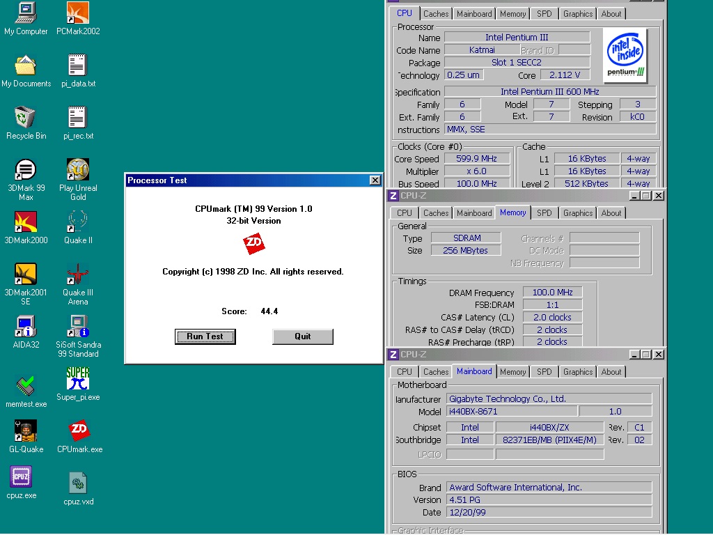

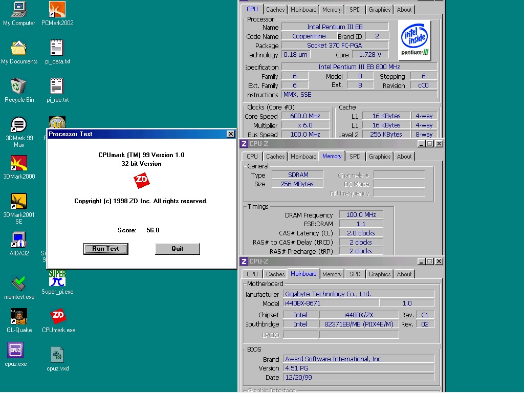

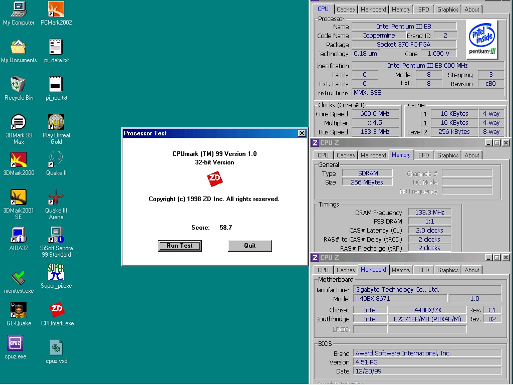

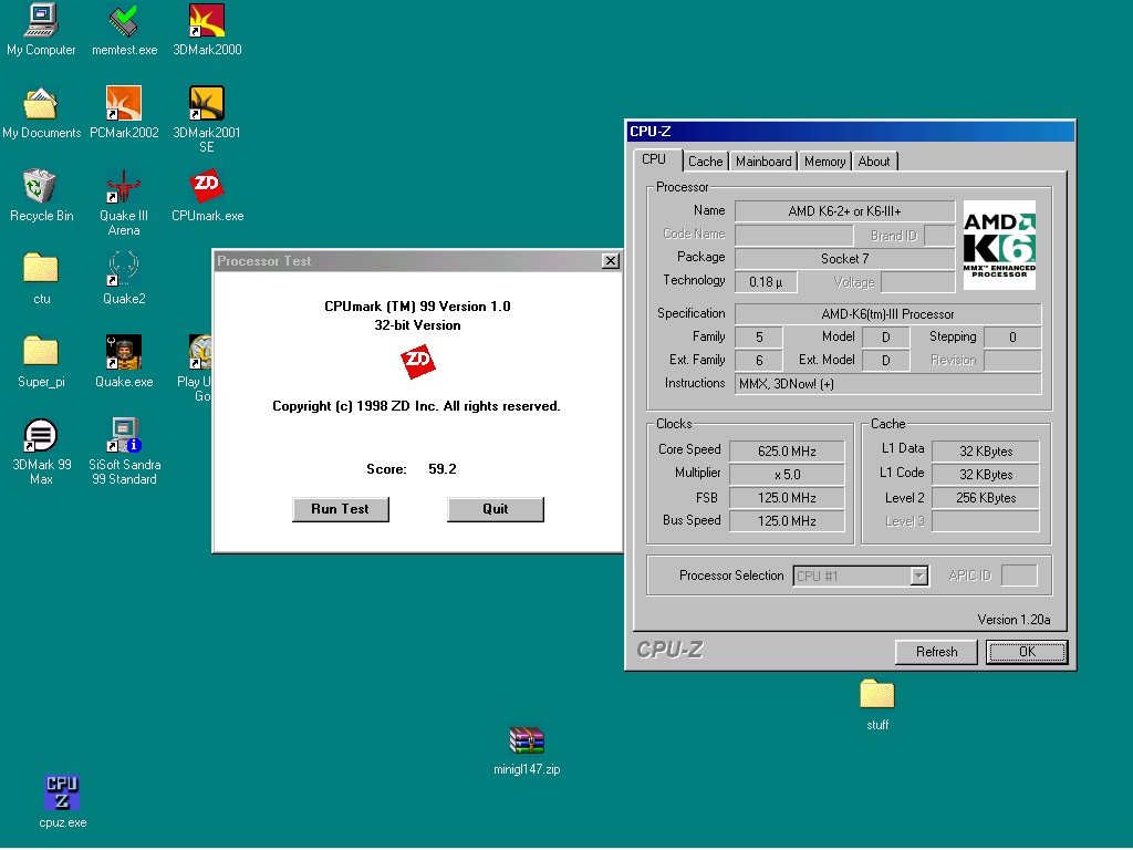

Reply 77 of 107, by Skyscraper
I thought that I would post some benchmarks where the K6-3+ really shines 😀 I will also post Pentium III scores as a reference.
First out is CPUMark 99
Pentium III Katmai 6x100 MHz, The slow cache really hurts the performance.
Pentium III Coppermine 6x100 MHz, The fast cache makes the Coppermine perform well.
Pentium II coppermine 4.5x133 MHz, More FSB equals more performance.
K6-3+ 4.5x130 MHz, Pretty much the same clock for clock performance as the Coppermine.
K6-3+ 5x125 MHz, Without onboard cache the clock for clock performace is a little worse but still @625 MHz it beats the Coppermine@4.5x133.
Edit added the K6-3+ @ 625 MHz
